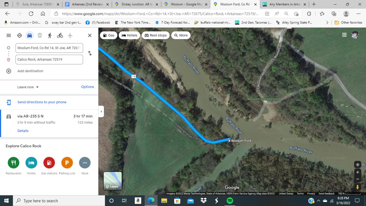

    Hey all, another specific question: how is Woolum Ford? I watched a video and seemed no big deal, but also read several reviews that said it was waist deep and difficult. Anyone been there and done that? Is it real? Google maps doesn't show it through however: DeLorme and the NFS Ozark maps do show it as a road.
    Just found the NPS site and there is posted a road closure to Woolum, so never mind...

    That's me in the white Taco, Woolum Ford is not a joke.

    IIRC the water gauge at St. Paul was showing 30" that day.
