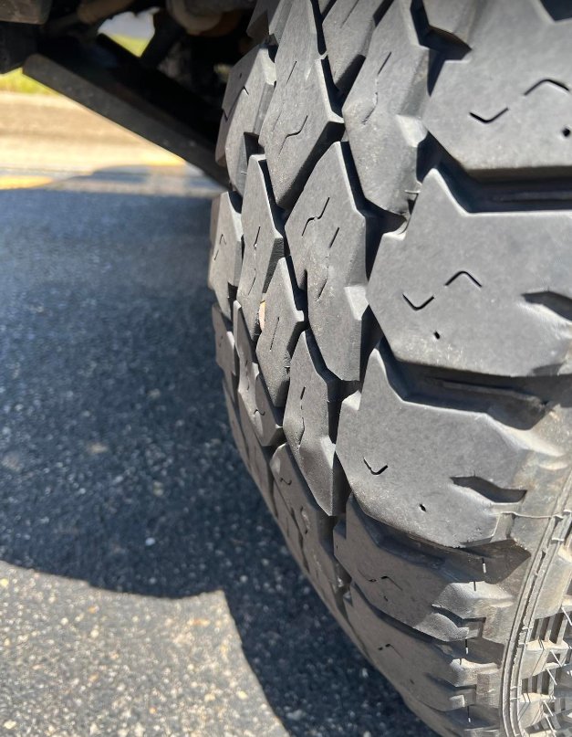

    *sigh*
    Is this an out of balance thing?
    CygnusX191 likes this.
  6. Jun 27, 2022 at 11:17 AM
    #8726
    TenBeers
    TenBeers Well-Known Member
    Jun 5, 2009
    #18067
    7,740
    Rich
    Bentonville, AR
    2018 TRD Pro Cavalry Blue
    Yeah.
    Possibly, but can also be caused by poor alignment, incorrect tire pressure, or worn suspension.
    CygnusX191 and CS_AR like this.
  7. Jun 27, 2022 at 11:21 AM
    #8727
    CRASHMAN50
    CRASHMAN50 Well-Known Member
    Jan 24, 2018
    #242257
    456
    AA-ron
    Arkansas
    '24 Tundra Limited TRD Lift
    I'm worried it's a belt failing too. Alignment is good, and they've been running 30-32psi for a long time.
  8. Jun 27, 2022 at 11:32 AM
    #8728
    Ozarklander
    Ozarklander Well-Known Member
    May 9, 2020
    #327482
    225
    2018 quicksand dclb
    Do you rotate often?
  9. Jun 27, 2022 at 11:34 AM
    #8729
    CRASHMAN50
    Jan 24, 2018
    #242257
    456
    AA-ron
    Arkansas
    Every 5,000 miles. I'm on the schedule to get them rotated at my 75k mile service Sat.
  10. Jun 27, 2022 at 11:48 AM
    #8730
    TenBeers
    Jun 5, 2009
    #18067
    7,740
    Rich
    Bentonville, AR
    Yeah.
    Are they E-rated? What size? That's very low pressure for E-rated. Doing the conversion with the help of a forum member, my 265/75 R16 E-rated tires need 37 psi. So far so good on even wear, just wearing faster than I would like.
  11. Jun 27, 2022 at 11:51 AM
    #8731
    CRASHMAN50
    Jan 24, 2018
    #242257
    456
    AA-ron
    Arkansas
    Yes, they are E rated. That's the pressure I got to when I chalk tested them new. 34-35 wasn't evenly distributed across the tread with the amount of weight I have.
  12. Jun 27, 2022 at 11:56 AM
    #8732
    TenBeers
    Jun 5, 2009
    #18067
    7,740
    Rich
    Bentonville, AR
    Yeah.
    Unpopular opinion here: The chalk test doesn't account for the dynamic load seen during actual driving. It's an old holdover from older tire technology. You should likely be running around 37. E-rated tires need a bit more pressure. :crapstorm:
  13. Jun 27, 2022 at 12:42 PM
    #8733
    Bat Trd
    Bat Trd Friendly Neighborhood Batman
    Dec 8, 2019
    #312850
    138
    Layne
    Hot Springs, Arkansas
    2014 Tacoma TRDOR DCSB 1D6
    Bruce Wayne taste on an Alfred budget.
    In my experience tire chop is caused by weak shocks that aren't able to keep the tire planted on the road.
  14. Jun 27, 2022 at 12:46 PM
    #8734
    TenBeers
    Jun 5, 2009
    #18067
    7,740
    Rich
    Bentonville, AR
    Yeah.
    Yeah, that's where my head was going based on my Google results. Seems like "worn suspension" is a likely cause. How many miles on your current suspension?

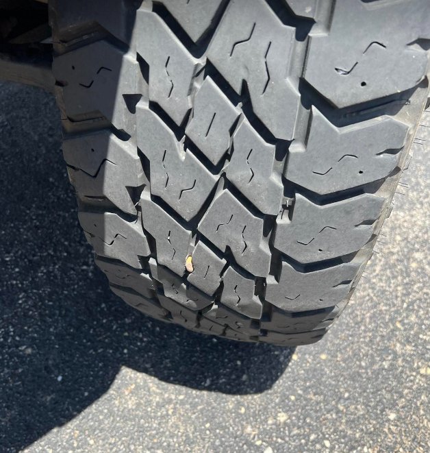

  15. Jun 27, 2022 at 12:56 PM
    #8735
    CRASHMAN50
    Jan 24, 2018
    #242257
    456
    AA-ron
    Arkansas
    Probably 35k miles on the Dobinsons that's under it.
    But I also realized the shadow may have been drawing my gaze. Upon closer inspection, it's the whole tire. Kinda alligator skin-like. :/
  16. Jun 27, 2022 at 1:17 PM
    #8736
    PinnaclePete
    PinnaclePete I am what I am
    Jun 2, 2014
    #131126
    4,185
    Pete
    Central AR
    '14 Sport DCLB Pyrite, 2015 DCSB Barcelona Limited
    SwitchPros 9100, Flip Pac, Stealth 6 Bronze, Toyo 255/80/17, MTO Tailgate Skin, RCI read diff plate, StopTech slotted disc and pads, OME 885 w/ NitroChargers, OME HD LeafPacks, SOS Rear bumper with swingout, BAMF Bolt-on Sliders, Rear diff breather, OEM roof racks, ECG perforated grill, BAMF behind grill light bar bracket with PIAA 510 4" yellow spots, US OffRoad bumper, Engo 9k winch, WeatherTech window vents and floor mats, Wet Okle seat covers, RedLine hood struts, Anti Dark hood lights, Baja amber light pods, Lamin-X amber flood covers, amber FlyEyes, Jumpers amber LEDs, Salix glovebox and center console organizer, MagLite mounted, shop made bed mount tool boxes, LogRite bed mount bottle opener
    Is it just the one tire? Looks like more wear and scalloping on the outside. Did you hit something, looks like front driver.
    I've always run my Toyo AT E rated at 32-34psi and have never seen that.
  17. Jun 27, 2022 at 1:21 PM
    #8737
    CRASHMAN50
    Jan 24, 2018
    #242257
    456
    AA-ron
    Arkansas
    Haven't hit anything that I recall. I may see if I can get my alignment checked.

  19. Jun 27, 2022 at 3:23 PM
    #8739
    HDMOTT
    HDMOTT lil_tacoma
    Jun 25, 2017
    #222358
    331
    Harrison
    Arkansas
    2013 Tacoma 4x4 2017 4Runner TRD Pro
    SCS BR6/ Bilstein 6112/5160/ BajaDesigns Squadron Sport Fog Lights/ BajaDesigns Squadron Pro Ditch Lights/ BajaDesigns S1 Flush Mount Reverse Light/ 32" Light Bar/ Rago Fab Ditch Light Brackets/ CaliRaised Lower Bumper Light Bar Brackets/ BPF Tow hook/ BPF TRD Skid Plate/ Bora 3/4in Wheel Spacers/ Icon 3 Leaf AAL/ BAMF HD Shackles/ TRD Pro Grill/ OEM Roof Rack/ OEM Bed Mat/ Nitto Trail Grapplers/ Every Bulb LED
    I run my E-Rated Nitto Trail Graps at like 27-26 psi in the rear during summer and like 28-30 psi in the front just to have a decent ride quality, and have never seen anything like that and they wear evenly. I'm also unloaded all the time with no added weight.
  20. Jun 27, 2022 at 3:25 PM
    #8740
    CS_AR
    CS_AR Well-Known Member
    Apr 3, 2019
    #289019
    12,949
    1999 Tacoma PreRunner TRD
    Everything but the driveshaft. B03A - 410
    I would get cupping regularly on FWD SUVs with struts and independent rear suspension as the struts would begin to wear.
