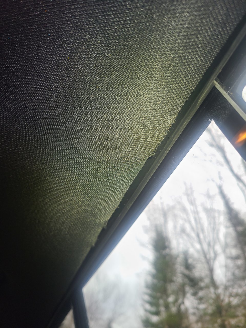

    Yes, be careful, body shop is replacing mine as we speak. They replaced my roof (tree fell on it) They had satellite remove and replace back windows and Windshield. Satellite screwed up both. They had to redo Windshield and replace back window. They messed up back edge of headliner. Now it's being replaced at a cost to them $1400.00

    You can have my black one, if body shop that's replacing it would give it to me. This is why they are replacing it. Like I mentioned $1400 is cost. Back edge fraid20221107_092141.jpg

    They ordered it from Toyota, it to 2 months to get it. Just like everything else these days.
