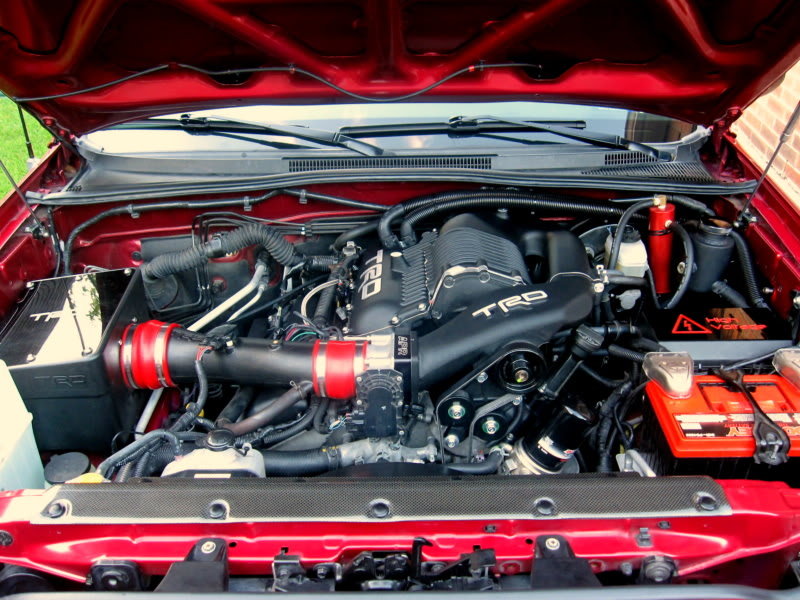

    Yes sir. It's the red bottle on the right. Definitely recommended.

    Are you running both valve covers into it?
    I see you are not running it with a K&N breather.
    How often do you drain it and how much does it collect?
    BTW, it looks awesome...

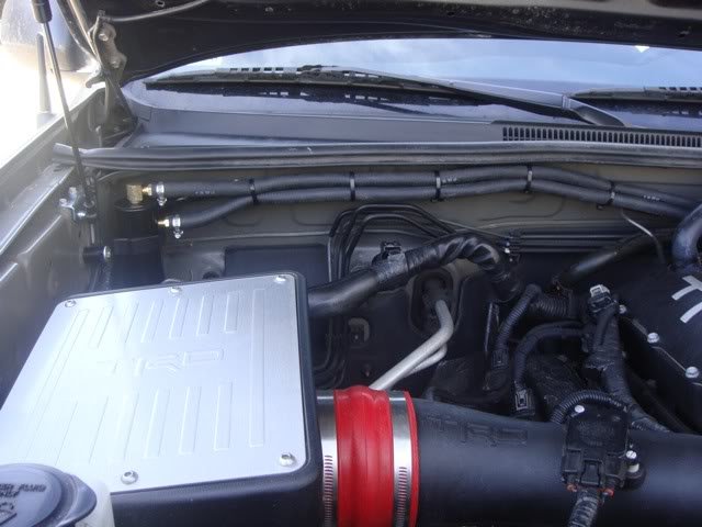

    A LOT
    here is mine, i got it from the same guy spacemonkey got his from on xr-underground like 6 months ago. i put it on the left side to have more room. easy mod, and works great

    What have you done to your truck lately
    Do u have a side view picture where to tie I too?
