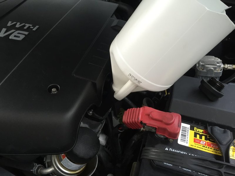

    I've always used an empty one gallon jug for a funnel for changing oil. Threads right where the cap goes. Who else does this and how many didn't know about this? image.jpgimage.jpg

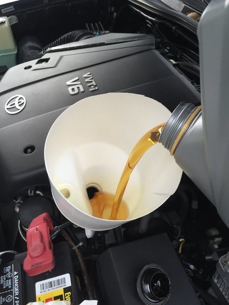

    One quart oil bottles thread right in as well. I usually buy the 5 quart oil jugs and an extra 1 quart. Once everything is drained i put half a quart in and let it drain as well, just to try to get a little more bad oil out. Plug everything back up, put the half quart left in, cut the bottom off of the 1 quart bottle and then i have a kick ass funnel to not spill from the 5 quart. Got tired of losing all of my funnels and having to rebuy one every time.
