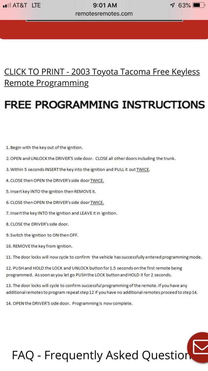

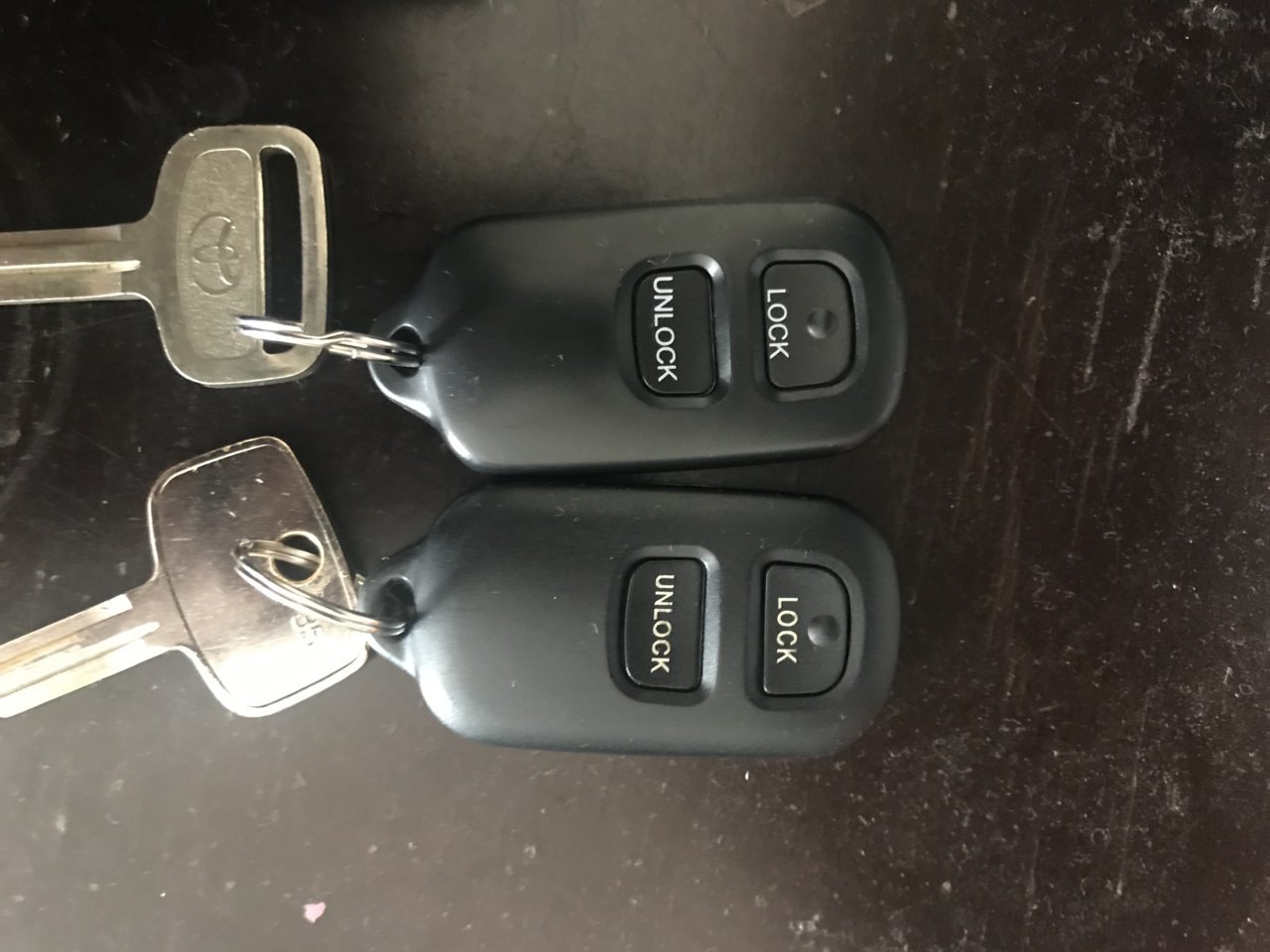

    I bought it from eBay and tired programming it with the instructions provided..
    My taco goes to programming mode but it doesn’t seem to find the remotes

    see if they have batteries first. If the batteries are good there is a remote tester tool at some auto parts stores... you push your remotes button and a light lights up on the tester indicating that your remote is actually transmitting.

    You could also point the emitter towards your cell phone's camera and see it flash on your camera screen if it's transmitting

    My remotes have red led lights on top.. Look a little different the those.
