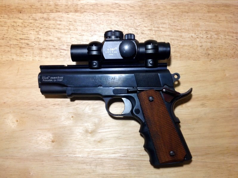

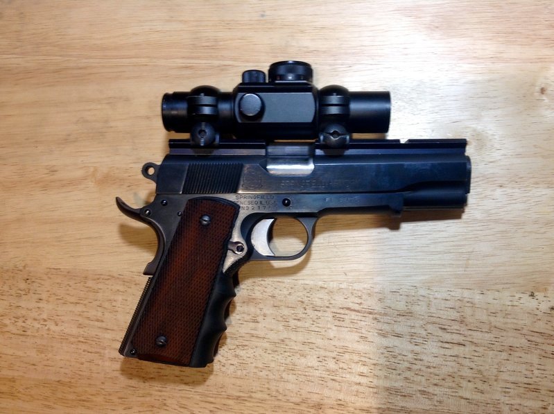

    My Clark custom 1911 built on a Springfield armory frame
    Built for target shooting

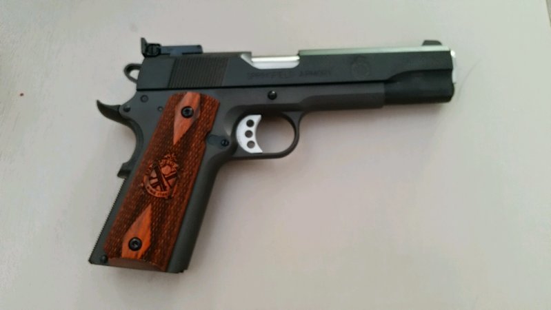

    My first and hopefully not my last is a Springfield Range Officer in 9mm.

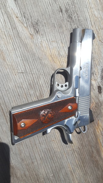

    Got my Springfield 45 out today and put a few rounds downrange. Had been too long.

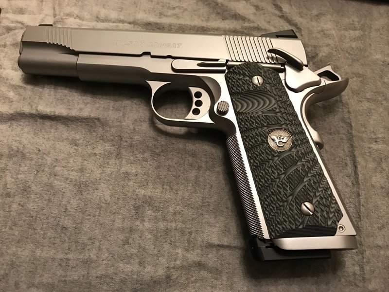

    Springfield Armory 1911 GI that I have been modifying for some time now. Short list of mods are
    Wilson Combat magwell, skeleton trigger, skeleton hammer, beaver tail, hex stainless screws, g10 tactical grips, pearce finger grip, dan wesson extended mag release & safety controls, polished feed ramp, polished ejector port, Springfield range officer springs
    This is just off the top of my head I am sure I am missing a few things. It is still a work in progress. I have used this gun as a platform to explor the 1911 and do all the mods myself.

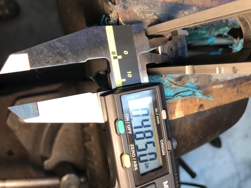

    There is no such thing, they are all the same overall length.
    What happens is the ejector hook is located based off the slot in the back where the firing pin stop (FPS) goes through it. Length stays the same but appears to shorten or lengthen based on curvature (tension) put into the extractor. Also the location of the slot for the FPS. An extractor has a set length it needs to be. Between the hook and the breach face should be between .070-.074" roughly. The face of the hook shouldn't be long enough it's pushing the case off the breach face. If the case won't sit flush to the breach face because the extractor is pushing it off then it's to long. To change that length I usually relocate the FPS slot forward some hence pulling the hook back. Also if it's a small amount on the hook face and the space between the hook and breach face is correct than I file the face of the hook.
    Tension, ability to clock, shape etc all play a role in reliability. When I do a reliability package it's very rare that a factory extractor and FPS survive the process, meaning they get replaced with oversized parts I machine to proper specs and hand fit. I hope this helped if not feel free to ask more questions.

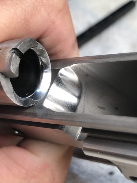

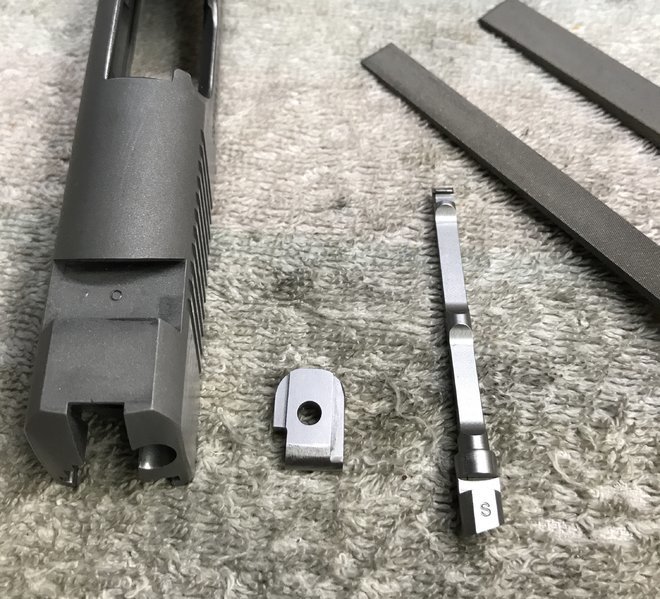

    Here is one I did today as part of a reliability package.
    Couple more pics of what all I do when doing a reliability package.
    Breach face was too narrow so I made it .005" over proper spec.
    Before
    After.
    Ramp was too short so I machined it to proper specs, throated the barrel, reamed the chamber and polished the chamber and ramp.
    Deburred the breach face, chamfered the firing pin hole, tuned the extractor, polished the breach face and disco track and broke the hard edge between the breach face and disco track. Plus a few other things.
