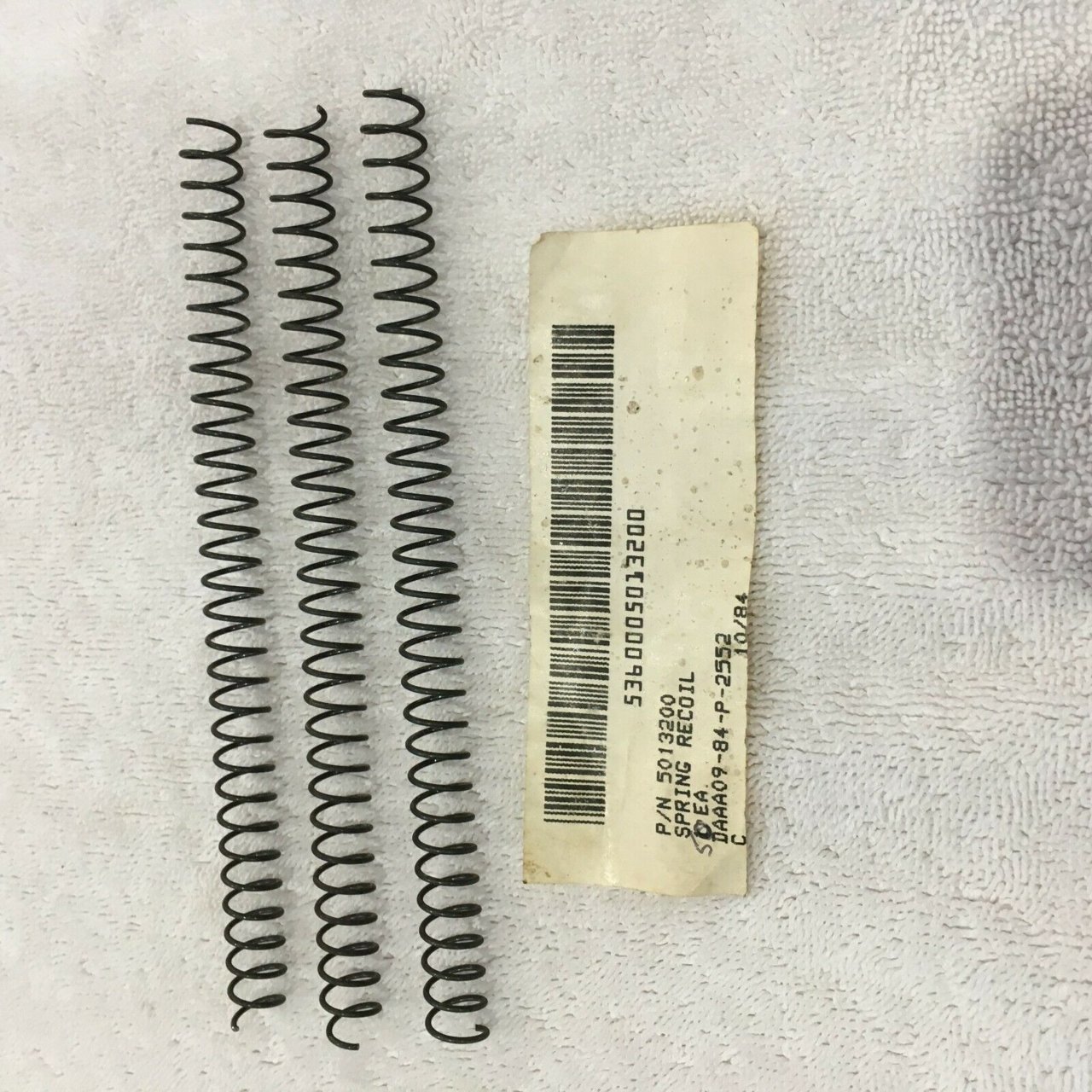

    My CMP Field Grade 1944 M1911A1 had a few minor issues the first time I fired it - wouldn't always fully close the first round when I released the slide stop and I got an erratic brass ejection pattern. Figured I'd replace the recoil spring - found some USGI made in 1984 - and did a tension check on the extractor. Both it and the ejector seemed to be good. The springs arrived yesterday afternoon - installed one today and took the pistol down to my range here at home. Functioned flawlessly - just needed some extra juice. No more getting bopped in the head and shoulders with hot brass. :crapstorm:
