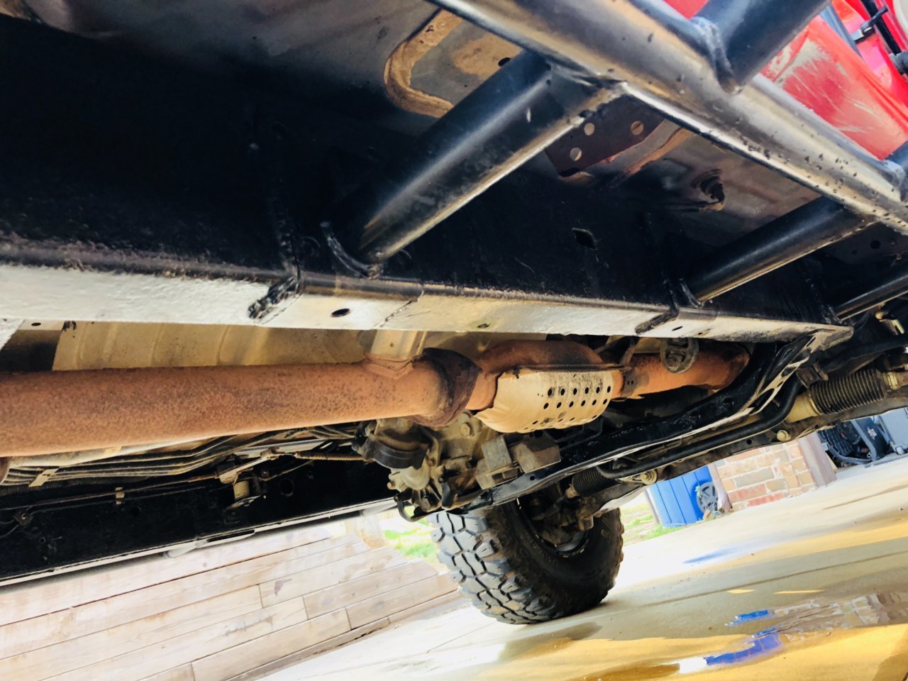

    I sprayed my frame with bedliner coating. It works great. Stays applied and looks 10x better than undercoat. I used the bedliner available in rattle cans from your local parts store or good old Amazon.

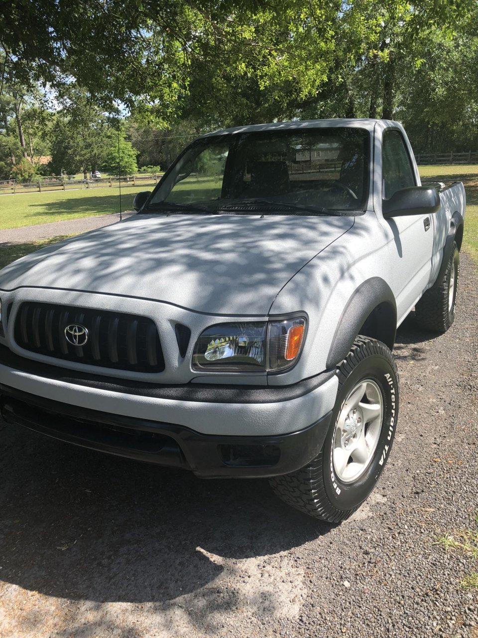

    I haven’t Line-X underneath, but I did have the exterior done in it.F1438D6C-9BD6-4A70-823C-1951FB07EE64.jpg
