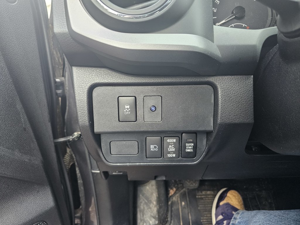

    I have this black-ops anytime locker installed. It was easy to do and it has worked flawlessly for the last couple of trips since I put it in. It clicks in and it clicks out. Works in 2wd, 4hi, 4low. The reason I needed it was because I installed an MC TacoBox so I wanted to be able to lock when I was in 4.7 reduction without selecting factory 4low.
    I chose the Black Ops over the experimental designs because I liked the switch and indicator light setup better. The Experimental has a little light that you have to drill and mount (I think...), whereas the Black Ops switch itself is backlit. I just liked that solution better, it seemed simpler, I dunno. Never heard anything but positives about the Experimental and I can offer only my good experience with Black Ops. Their über-bro militia marketing almost turned me off though, not exactly a fan of Call of Duty.

    having just a little light and oem switch seemed simpler than adding a whole new switch to me.

    if this Black Ops one isn't using the Overhead diff lock button, what does that button do now? Could I just remove the overhead button then, and install this in its place? That would seem like the ultimate PNP solution

    Yes, you have it correct. I didn't do it that way because I have switch space to spare and it was easier to plop it in with the others in front of the shifter. You certainly can run it up the A pillar and use the overhead spot. I believe you still need to retain the factory switch (not certain), so don't disconnect it and just tuck it up safe. Mine is still wired up, I never touched it. In fact, I think it's bypassed now and doesn't work anymore.
