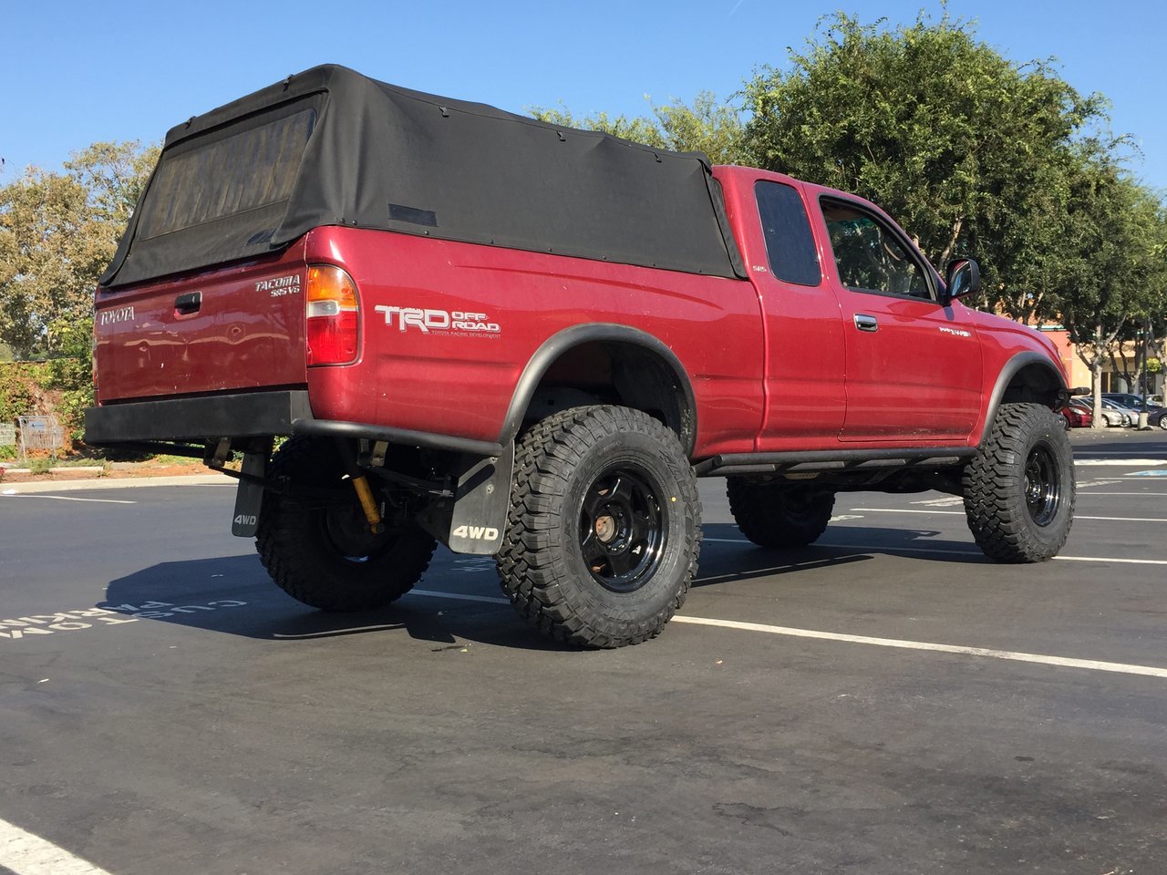

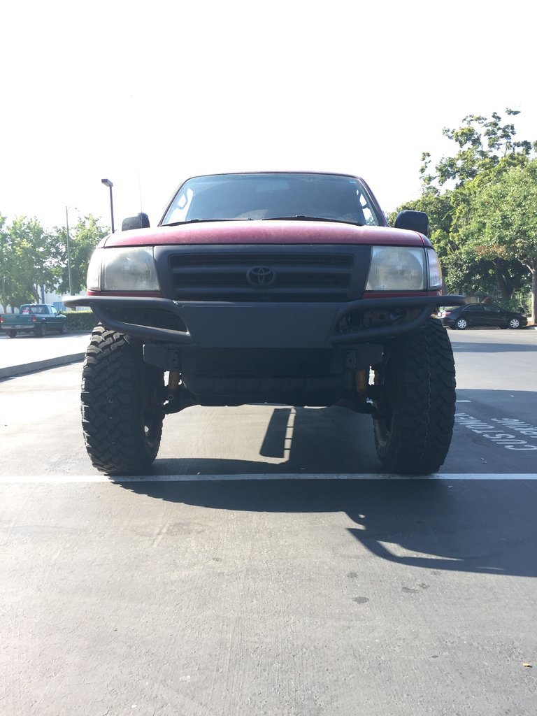

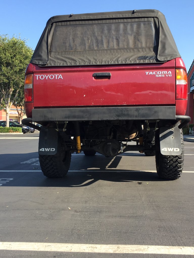

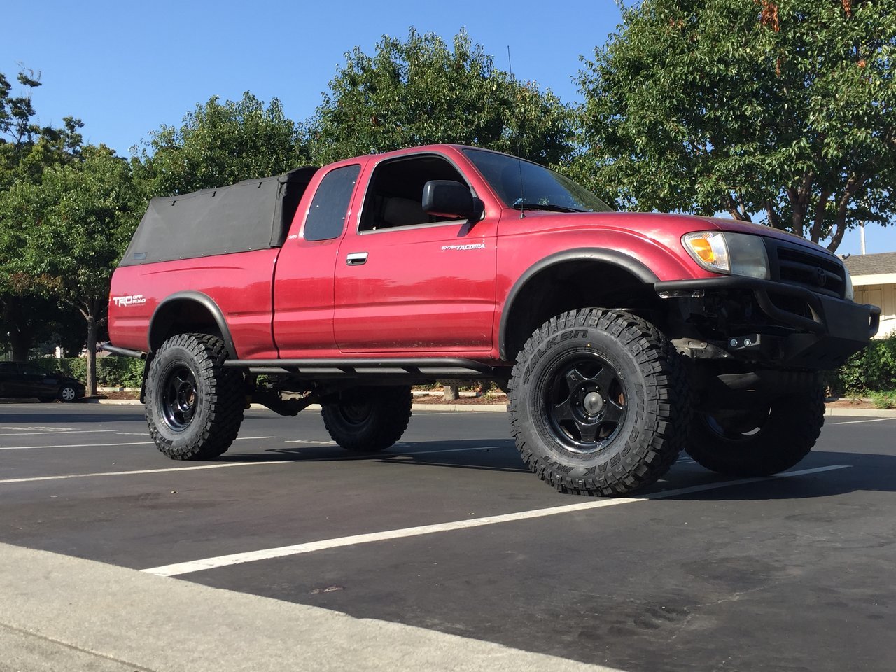

    Never turned a wrench on a Gen 1 before yesterday, you guys got some funky shit to deal with compared to the Gen 2.
    Love the choices you made, really well thought out and quite the transformation.
    Those mudflaps look a little small now. :D

    Man, can you help me build a rear bumper like that?!
