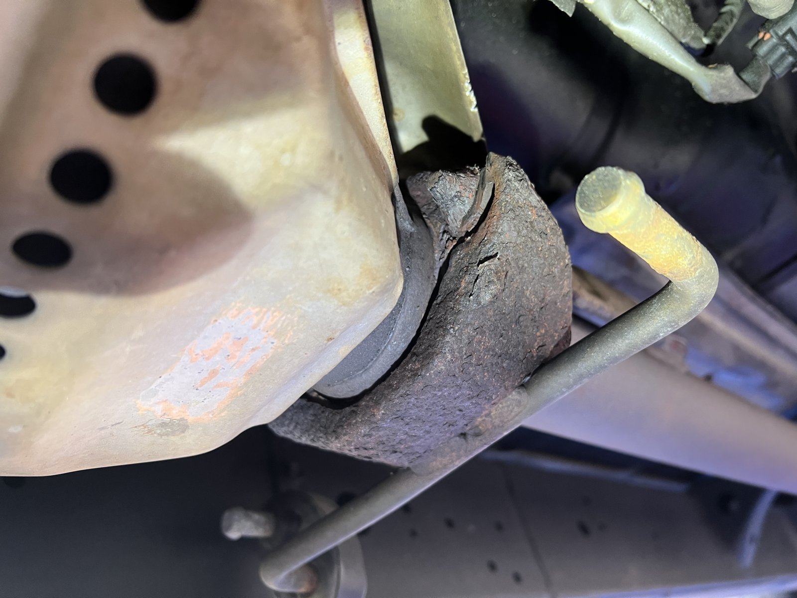

    My truck is pretty nice underneath besides the exhaust, can’t protect that. I had to cut the bracket to get the catback off, religious (holy) muffler.
    any options to buy the bracket please? NLA from Toyota and google didn’t help me

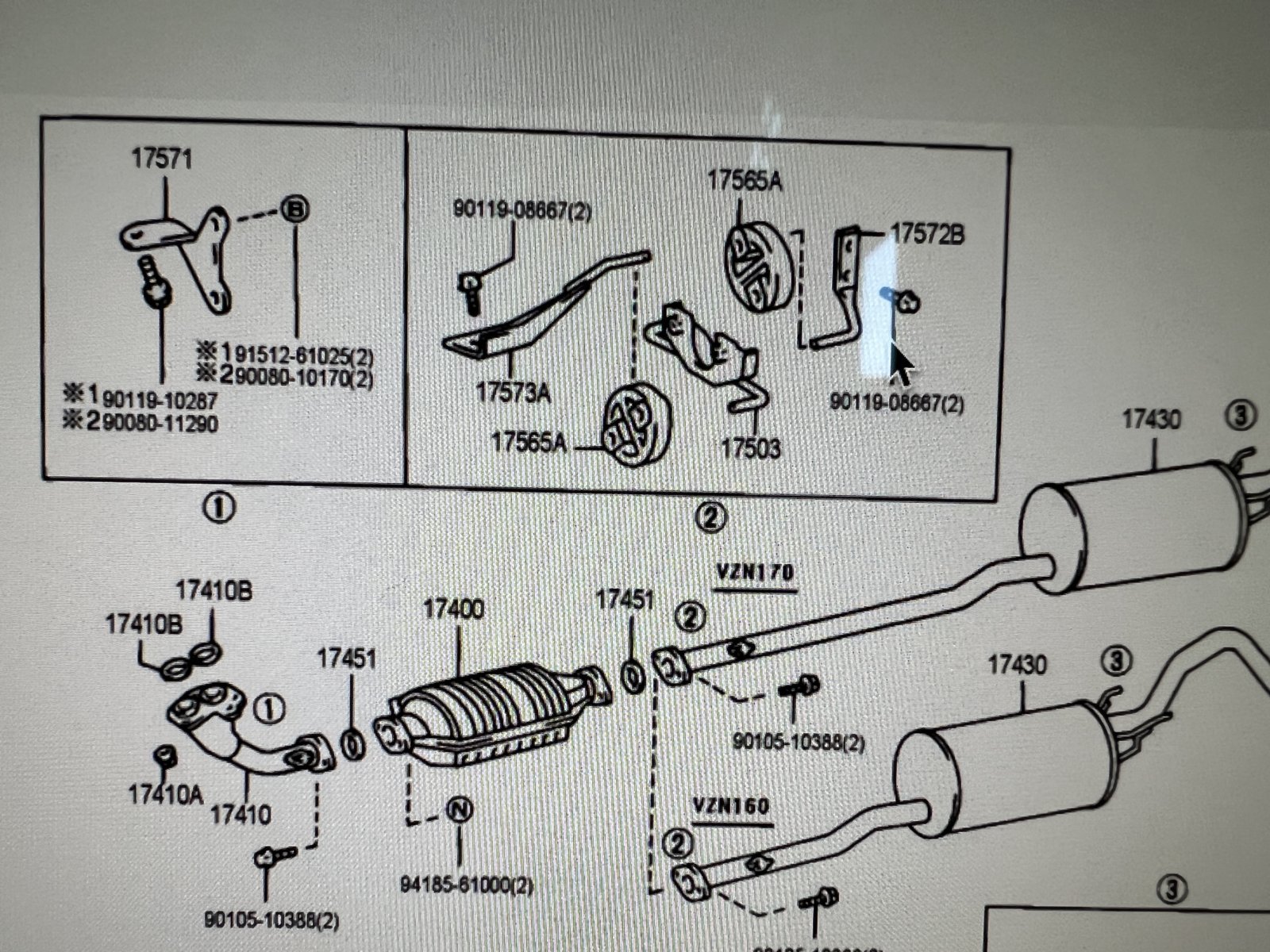

    17503 in the diagram, full pn 1750375010, supersedes 17503-75010

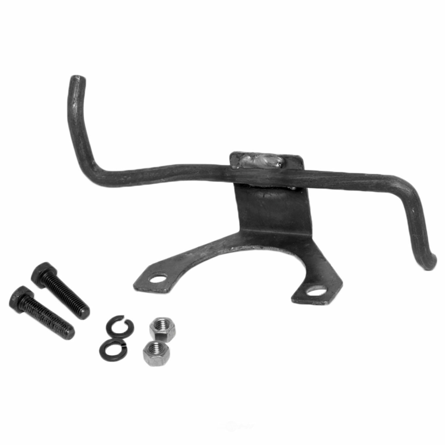

    Walker Exhaust has a bracket very close to the Toyota one.
    No doubt much cheaper.

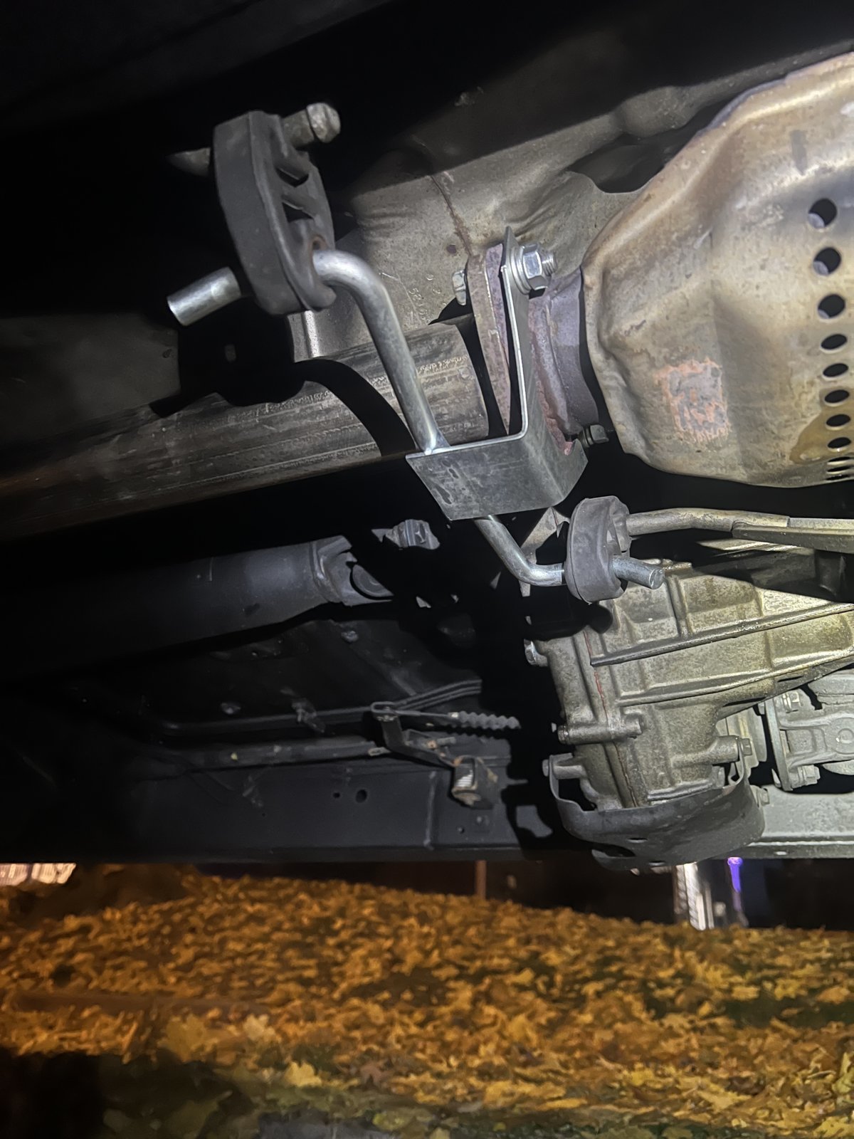

    Bought that exact one yesterday, thanks y’all!
