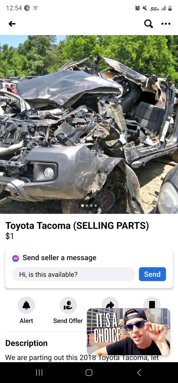

    Haha, not sure the motor pictured is gonna do it. :p
    I have considered trying to find a junk yard, but I think that's more risk than I want to take on. I'd rather something rebuilt with at least some kind of peace of mind that I'm not going to be back in the same boat immediately.

    How far away are you from the poor dude who got his shit wrecked by the VW ? Perhaps you can pirate his engine before they total it.
