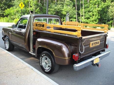

    Uh, if my experience with my old stake bed trucks serves me right...this ain’t that kind of truck.

    Looks OK on a Warlock!

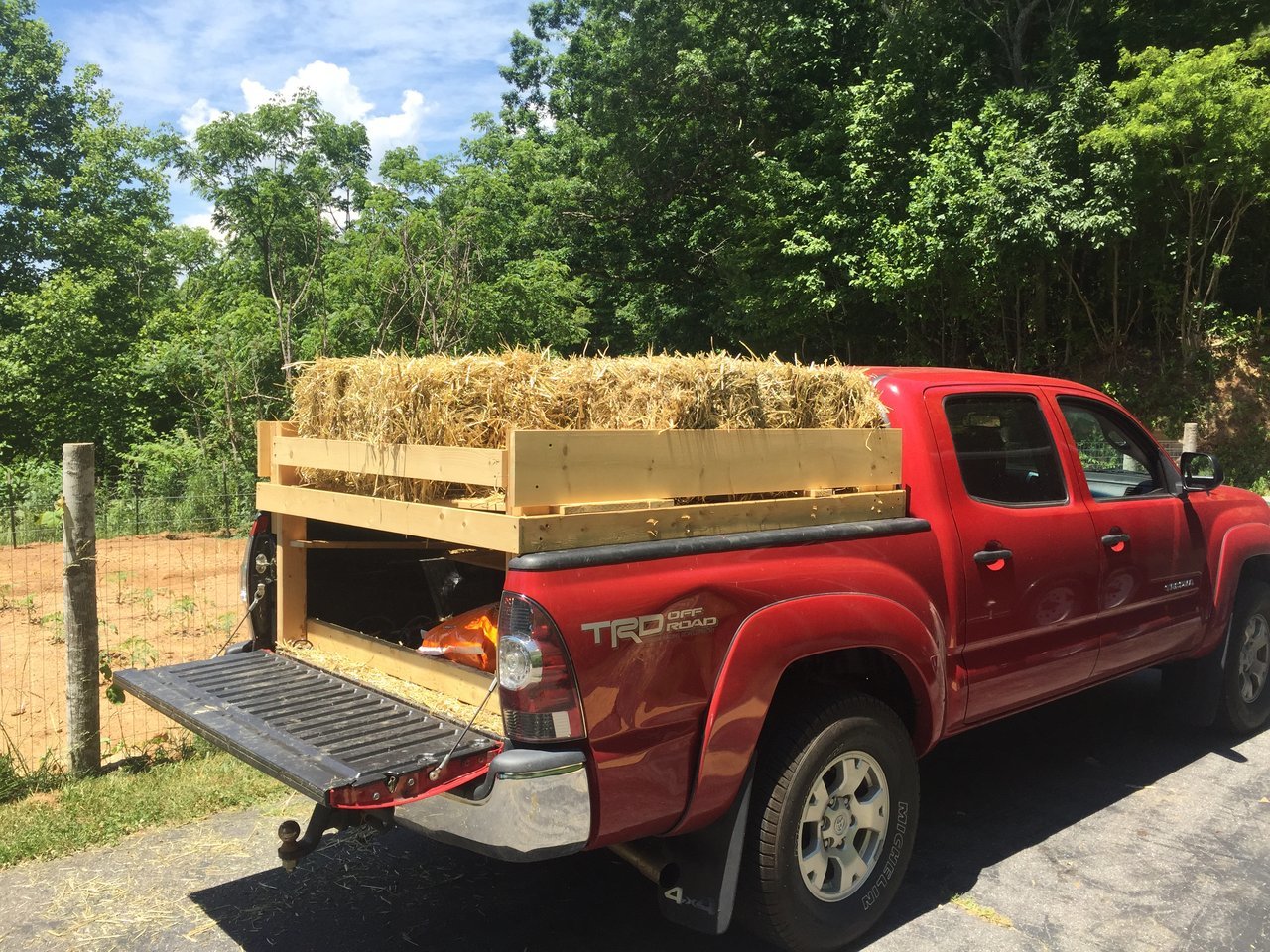

    apparently not a majority of you have been on a farm. i'm sorry. let me restart this; i haul some loads that extend above my bedrails. rails to secure the load or to tie & secure to would be in order. i mean, hasn't Any tacoma owners done this for larger loads??

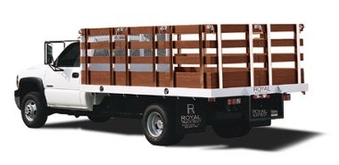

    The Tacoma is a fantastic truck, but I don’t think it’s the best truck for a farm. The bed rails don’t have stake holes, so you’d have to cut it. Not sure what that would even do to the composite bed.
    I think a full size is better for just about any farm application where stakes would be needed.

    Ya, I don't think the composite bed would support the weight of the risers over any off-road/rough terrain. My work trucks all have headache racks, and without supporting them properly (resting on bed rails) we crack steel bed sides constantly.
    I would vote for either a trailer, or a flat bed with stake pockets. Flat bed would be my first choice. Same cost as a decent sized utility trailer, plus nothing to drag around that would year up your field.

    Ahh, that's perfect. The weight of the uprights is put on the floor of the bed....
