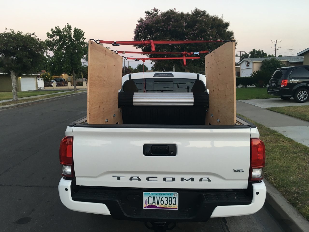

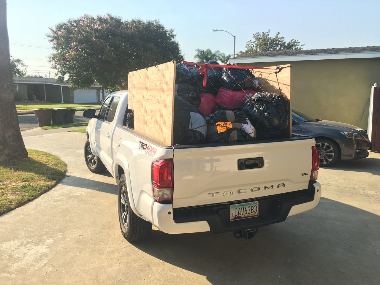

    It's not pretty but I had built some last minute walls out of 8x4 sheets of ply. Bolted them to the side rails with the right carriage bolts and nuts.
    They went all the way to the bed floor. And were measured just tall enough that they collapsed flat between the Wheel wells when not using them. So they also doubled as a bed mat.
    I drilled a few holes along the perimeter to pretension the walls inwards with a few tie downs along the top front and back.
    Worked great holding a bunch of retail merchandise on a 7 hour over the mountains road trip between Phoenix and la.
    All in was about $100 in materials. I always thought the collapsing bit made it a clever design and maybe one day of optimize the design and work to get them made out of a prettier looking material with some better configuration options. Say a fiber impregnated plastic.
    And then I realized only a few of us would use them. IMG_8752.jpgIMG_8762.jpg
