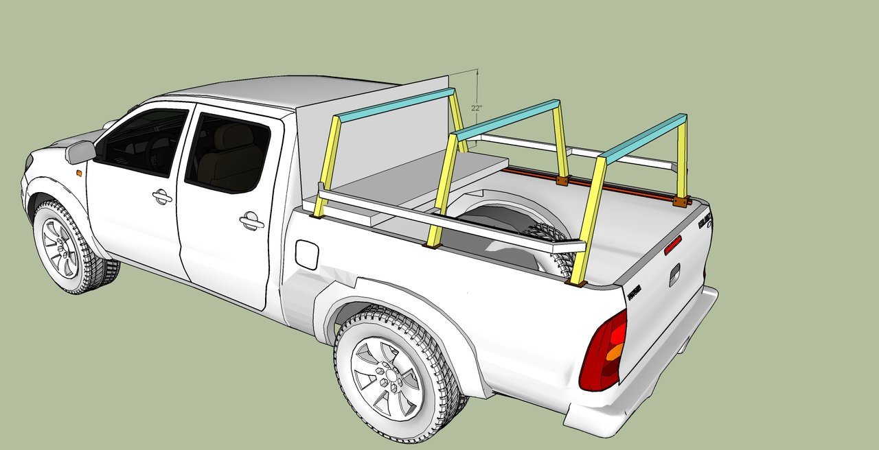

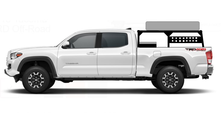

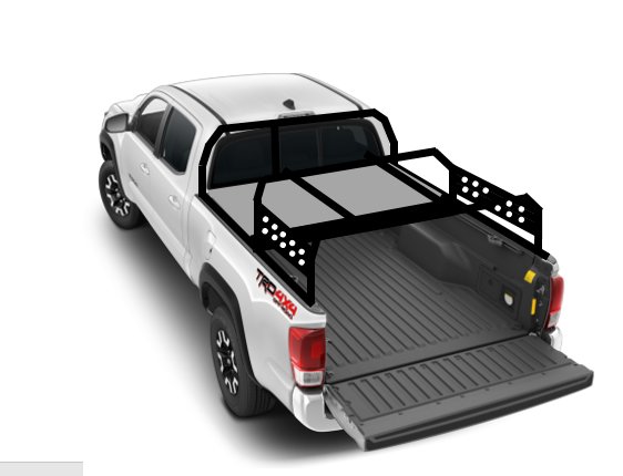

    Ok...let me see if this will work. I'm new to "adding photos" to threads. And apologies...I'm no graphic designer.
    EDIT: I should mention that the second picture is obviously a short bed, but you get the idea.
    WPNZ, pat's taco, Skell and 1 other person like this.

    The lid on your toolbox is square, this won't allow the toolbox to open all the way correct?

    Actually it is obviously a long bed also.

    HA! You are correct, sir. I stand corrected.

    If the risers are "outside" of the truck box and extend vertically far enough then the lid should open just fine. The issue with most racks are 1) the risers angle in too far to allow the lid to open and 2) there is usually a brace across the top running the length of the truck bed, which would prevent the lid from opening all the way.

    Based on the dimensions of your box lid, the risers are going to have to go straight up to a point above the cab for the lid to operate.

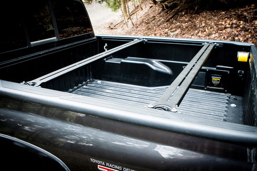

    Since he can't provide any reference. Here's an example OP of bed bars that attach to the bed rail system. I believe you'd need more support though for a RTT.
    http://www.kbvoodoo.com/shop/toyota-tacoma-bed-bracket-fits-years-05-pair
