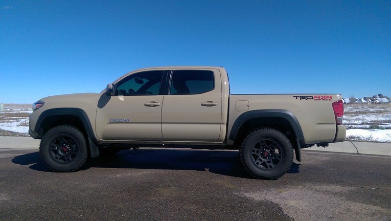

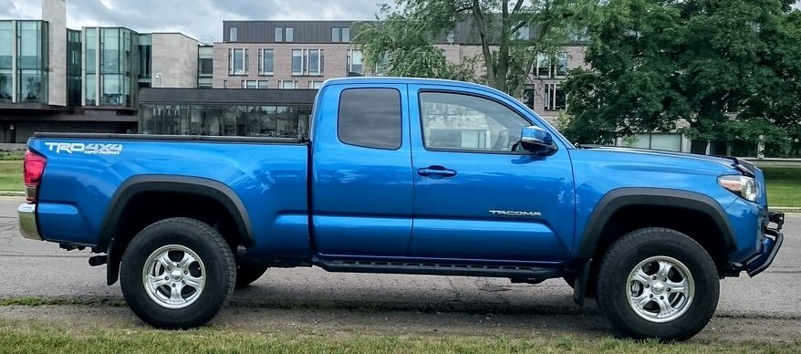

    Same deal as the above poster. 0d3ac0eb-da37-4882-834d-cb3a31c8e705_zps_5f7e24e55f6450c767525db286f7a872eaac414c.jpg IMG_20160715_164554_zpsj7e8as4p_7c44a9a7f6e0d08f281c76d14bf8fa452b07829c.jpg

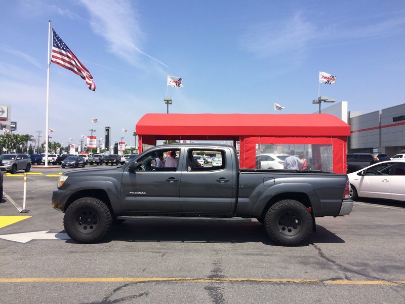

    Here are 2 pics with 5100 set at 2.5. The bed was sagging with the old springs and even when the new replacement (recall) springs were put in. I had to add the icon AAL (no pic posted) and leave the overload in for the truck to look GOOD!. I guess you could set the 5100 to 1 or 2 and not need the AAL but only if you are running smaller tire. I am running the LT285/75R16 AT TAKO2 RWL which are 33s.

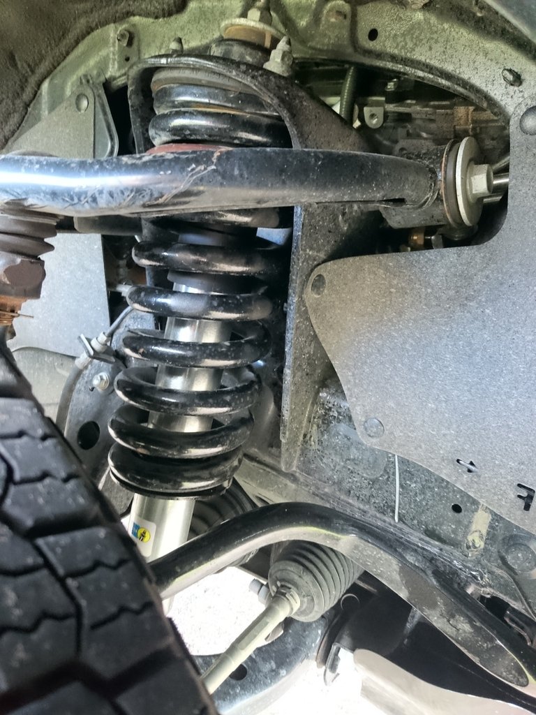

    Nothing done to back, but swapped out OEM yellow Bilsteins for 5100s. Front has 5100s & ToyTec adjustable coilovers cranked up to level with rear, which would be similar ride height to the .85 clip position if running 5100s with stock coils.
