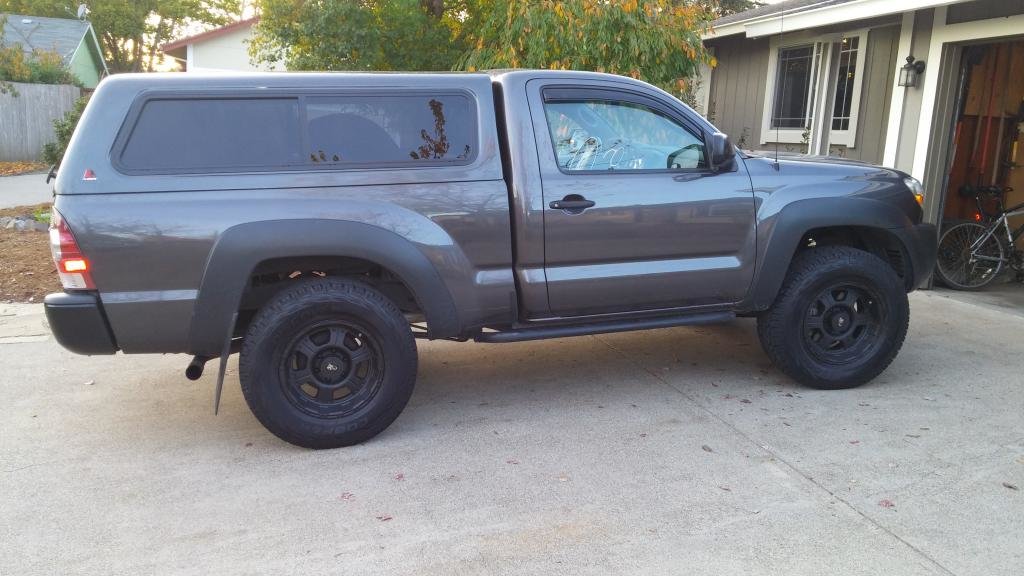

    LT275/70/17 Hankook ATm

    What lift do you have on your truck?

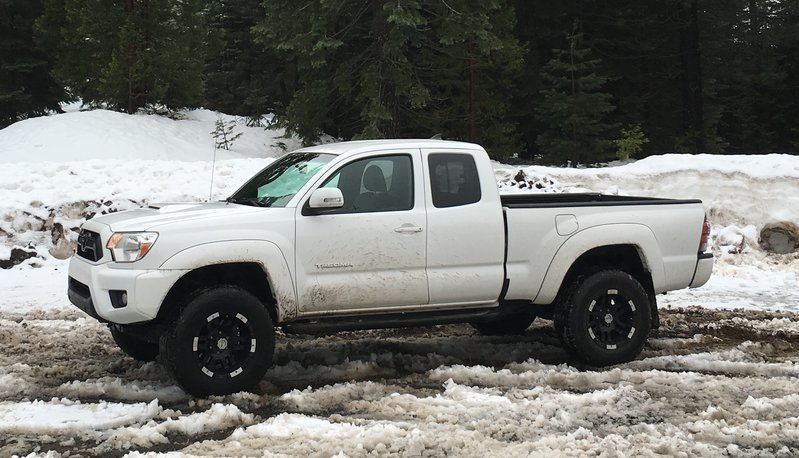

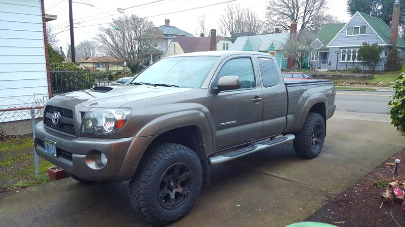

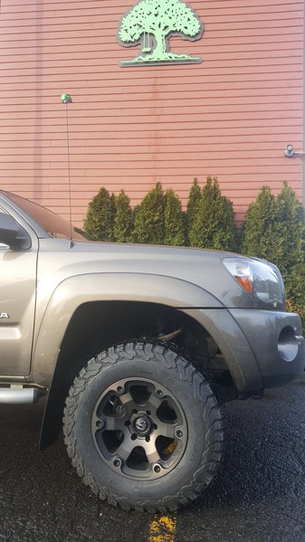

    275-70-17 BFG KO2
    3 inch lift with a add a leaf in the back

    OME 885's and Dakars

    I love my Goodyear Duratrac I have on currently, just wish they sold them in 275/70/17's. My second choice will be the BFG Ko2 tires in 275/70/17's in the future. PS: By the way the Tacoma with the BFG's your truck looks awesome!

    You should be good will probably have to take the mudflats off

    I don't rub , still have my mudflaps on

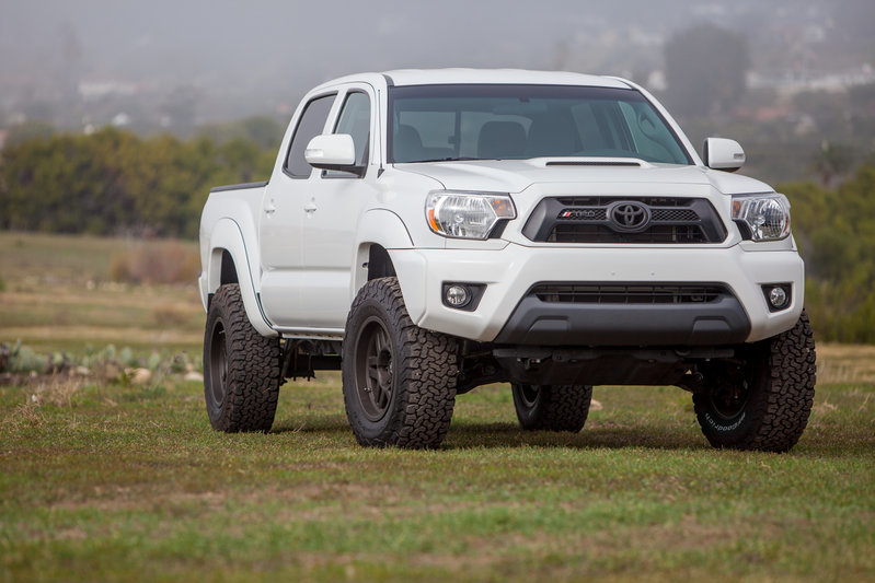

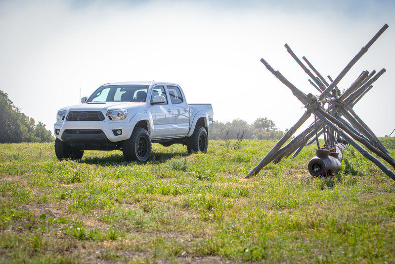

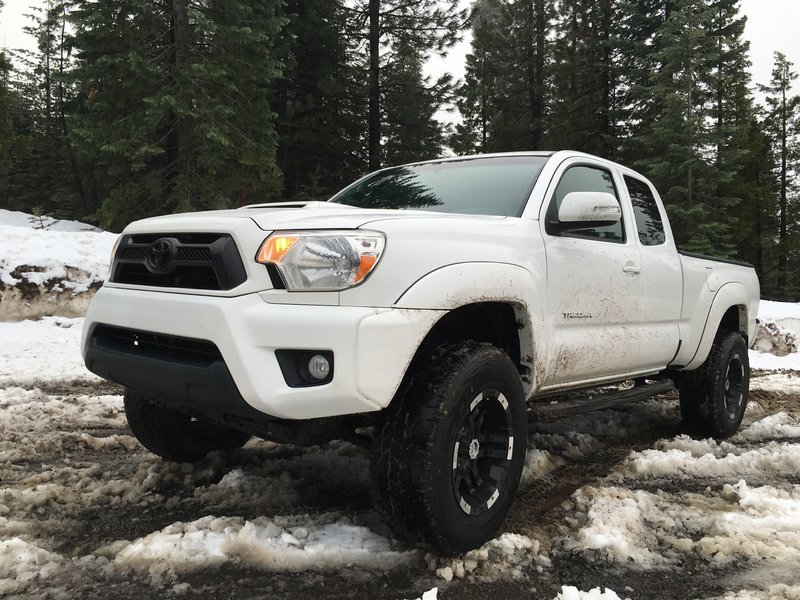

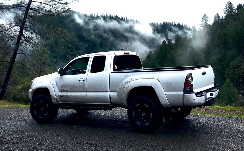

    275/70/r17 Cooper Discoverer AT3's

    What's it weigh?

    Never mind...55lbs. $308.00 per tire at Kauffmantire.com.

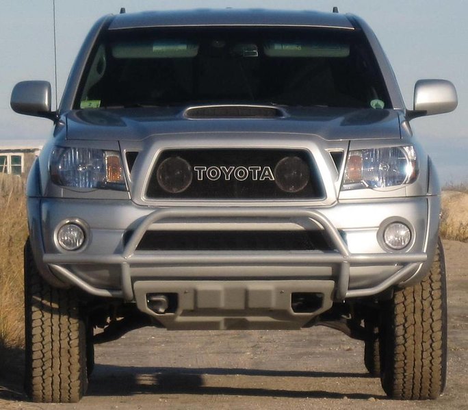

    SOS Concepts Sliders waiting for POR-15 Rust Abatement (Spring 2016), OEM Silver Tube Steps 'til then OME 2.5" Suspension w/885 Coils & Dakars / LR UCA's w/SpecRide Bushings / Lifetime Alignment Wheeler's "Super Bump" Bump Stops Front & Rear / OME Carrier Bearing Drop / 2.5° Axle Shims (Eliminated Vibration) Moog Greaseable LCA Cam Bolts / ToyTech Sway Bar Relocate Kit / Stainless Steel Extended Brake Lines (Front & Rear) TIRES - LT275/70R17 (32.2") Firestone Destination A/T's (and Matching Spare) mounted on (5) 17”x8” (4.5” BS) Machined Aluminum Alloy, with Light Gunmetal Accents, Konig SixShooter Wheels with Hofmann Anthracite Adhesive Power Weights / McGard 65002 Chrome SplineDrive Lug Nuts / Cloned Schraeder EZ Sensor 33000 TPMS SNOW TIRES - Bridgestone Blizzak DM-V1 - P255/75-17 (32.1") mounted on Stock TRD Sport Wheels (5.5” BS) w/BORA 1" Wheel Spacers (to = 4.5” BS), Wheels Locks & OEM Lug Nuts Wheel Master 36" Stainless Steel Mesh Spare Tire Inflator/Checker attached to Rear Bumper / Spare Tire Lock TRD Skid Plate / Husky Mud Flaps / Redline Tuning Hood Struts / UltraGauge / Frame Hole Plugs / OEM Chrome Exhaust Tip Salex SLX102 - '05-'13 Tacoma GloveBox & Console Organizers Combo Set / GRID-IT (Console Cover Organizer) Color Matched SATOSHI Grill w/ Individual Letters Toyota Emblem (from ‘86 Toyota Land Cruiser) Hella Fogs on Elusive Elements Light Bar mounted behind Grill / Relocated Horns & Outside Temperature Sensor SilverStar zXe Headlights / SilverStar Fogs / Upper & Lower Color Matched Eyelids / LED's @ Dome, Maps, Lic Plate & 3rd Brake / 866 Foglight Lamps for Back-Up Lights WeatherTech Headlight & Foglight Protection / AutoBahnd RoadBlock (3M) Paint Protection System on Front End & Tailgate Avid Hitch Step Color Match Powdercoated / Avid LightBar Color Match Powdercoated / DIY Front Plate Holder mounted on AVID Light Bar (NO Bumper Holes) Emblems DeBadged / CBoy808's Silver OME EMU, Medium Gray Mall Rated, TRD Skid & Matte Black US Flag Decals SockMonkey Medium Gray Shadow Only Bedside, Door, Hood Scoop & Tailgate Decals DeBadged Leer 100LX Cap w/ Adventure Pkg including Thule 48” & 60” AeroBar Locking Removable Racks, Removable Front Window & Rear Door Remote Lock Charcoal/Blk Wet Okoles (front & rear) w/Front Seat Back Waterproof Zippered Pockets, Front Pistol Pockets & Seat Heaters / Drop Stop Seat Wedge Fillers 6 CD Changer w/SubWoofer (TRD Sport OEM) / BluLogic Hands Free (Blue Tooth) / Lutron Maestro Pico Remote Control for Driveway Floods Pro-Fit & Pro-Clip Device Holders for Cell Phone & GPS / Beltronics RX 65 Blue Detector / Garmin 885T GPS 30% Tint on Driver/Passenger Windows / WeatherTech Dark Front Window Deflectors / AutoMate AM-7 Alarm w/Remote Start WeatherTech FloorLiners (Front & Rear) / WeatherTech All Weather Mats (Over Front Liners) TRD "Offroad" Front Recovery Hook (Color Matched) / 2" x 30' & 3" x 30' Recovery Straps ELITE OffRoad 2" Receiver Hitch Shackle / Daystar Black Shackle Isolator / LifeLong Locks Class 5 Locking Hitch Pin Viair 00088 88P Portable Air Compressor / Rockford 12,000mah, 200/400 Amp, Portable Power Source & Mini Jump Starter Pop&Lock PL5305 Manual Tailgate Lock w/Color Matched Handle / Driver's Door Keytechniques Keyhole Cover OEM Bed Mat / 4 Extra Military Issue Bed "D" Rings Attached with Bed Bolts / 4 Extra Bed Rail Tiedowns & 2 Mini Tiedowns H3R Performance Halguard Halotron® 1 (Clean Agent) - HG250C 2.5lb Chrome Fire Extinguisher and Extreme Duty Quick Release Bracket (Mounted in Bed) H3R Performance Halguard Halotron® 1 (Clean Agent) - HG100C 1.4lb Chrome Fire Extinguisher (In Cab Back Door Pocket) H3R Performance MX500R - 5lb Dry Chemical Fire Extinguisher w/ Vehicle Mount (On Cab Back Floor, Not Yet Mounted in Bed) ResQMe GB0-RQMTWIN-O Orange Keychain Version of the Original LifeHammer (Hanging Within Reach in Cab) FogLight Anytime / Differential Breather / A/C Condensate Drain / Tailgate Hoseclamp Anti-Theft Mods Toyota Extra Care Platinum Vehicle Service Agreement (VSA) – 8 Year / 125,000 Miles TSB's: Transmission TSB / Blower Motor TSB / Steering Intermediate Shaft Bushing TSB 90L Accelerator Pedal D0L Recall / Driver & Passenger Seat Belts Recall / Inspect Wheels & Tires "BOB" Recall The “TW EMPTY UR WALLET MOD” and a Pile of Stuff Waitin' for Install
    LT275/70R17 Firestone Destination A/T's on 4.5" Backspace Wheels - 32.2" Dia / 8.4" Tread Width
    OME 2.5" Lift - 885's & Dakars
    Also Run 255/75R17 Blizzaks on Stock TRD Sport Wheels (w/1" Spacers) - 32.1" Dia / 8" Tread Width
    Similar Fitment
    CC
