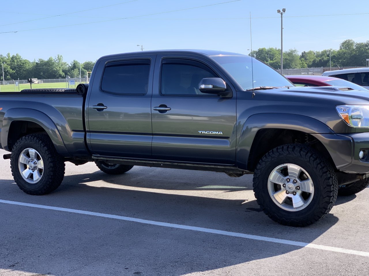

    THECHIPPER
    THECHIPPER Active Member
    Dec 5, 2015
    #171495
    36
    Blaine
    2011 TRD Acesscab
    Stock uca and no rubbing on them

    Awesome thanks man ..was the power loss really noticing with the extra weight of the 275ko2? Last question I promise lol. I think everything should clear and work well with 3 inch of lift in the front

    THECHIPPER
    Dec 5, 2015
    #171495
    36
    Blaine
    2011 TRD Acesscab
    Not really noticeable still has enough power. In reverse I sometimes rub on the plastic fender in the front. Not a big deal I just need to fix when I get a chance

    Will 275s work with no lift?

    R0dzilla75
    R0dzilla75 Well-Known Member
    Feb 19, 2015
    #149038
    446
    Rodney
    Virginia
    05 Sport
    HID fog light 265-70-17 Firestone destination ATs Led interiors lights TRD seat covers
    My 265/70/17 are close as hell on sharp turns. Don't know how you guys are running bigger and not rubbing but more power to you.

    2021 TRD OR 4x4 DCSB
    Sure it'll work....if you don't mind rubbing.

    2012 DCLB Tacoma 4.0L
    Thats what i figured, may have to trim up the fender flares a little

    Hello David. I have the same set-up. 2011 TRD with the 6112 Bilstein's. Did you end up getting the larger 275/75/17's? If so, how did the fiment turn out? Got pics to show? thanks Ryan

    2013 MG DCLB TRD Sport
    5100, OME 885, 1.5” Icon AAL, KO2 275/75/17
    Old thread, just curious if you fixed this and if so how did you go about it? Just got mine installed today and noticed the reverse rub a little while backing up.

    Were you happy with the 275/70/r17s? I am about to lift my 2015 2.5" with a Bilstein 6112 and want to grab these tires. Have never seen them in person. Wondering it they will look small.
    I’m running the 2.5” and have these tires. The tires have their pro and cons. Be prepared to fix rubs if not changing stock rims. Also be prepared to chase vibration in the rear.
