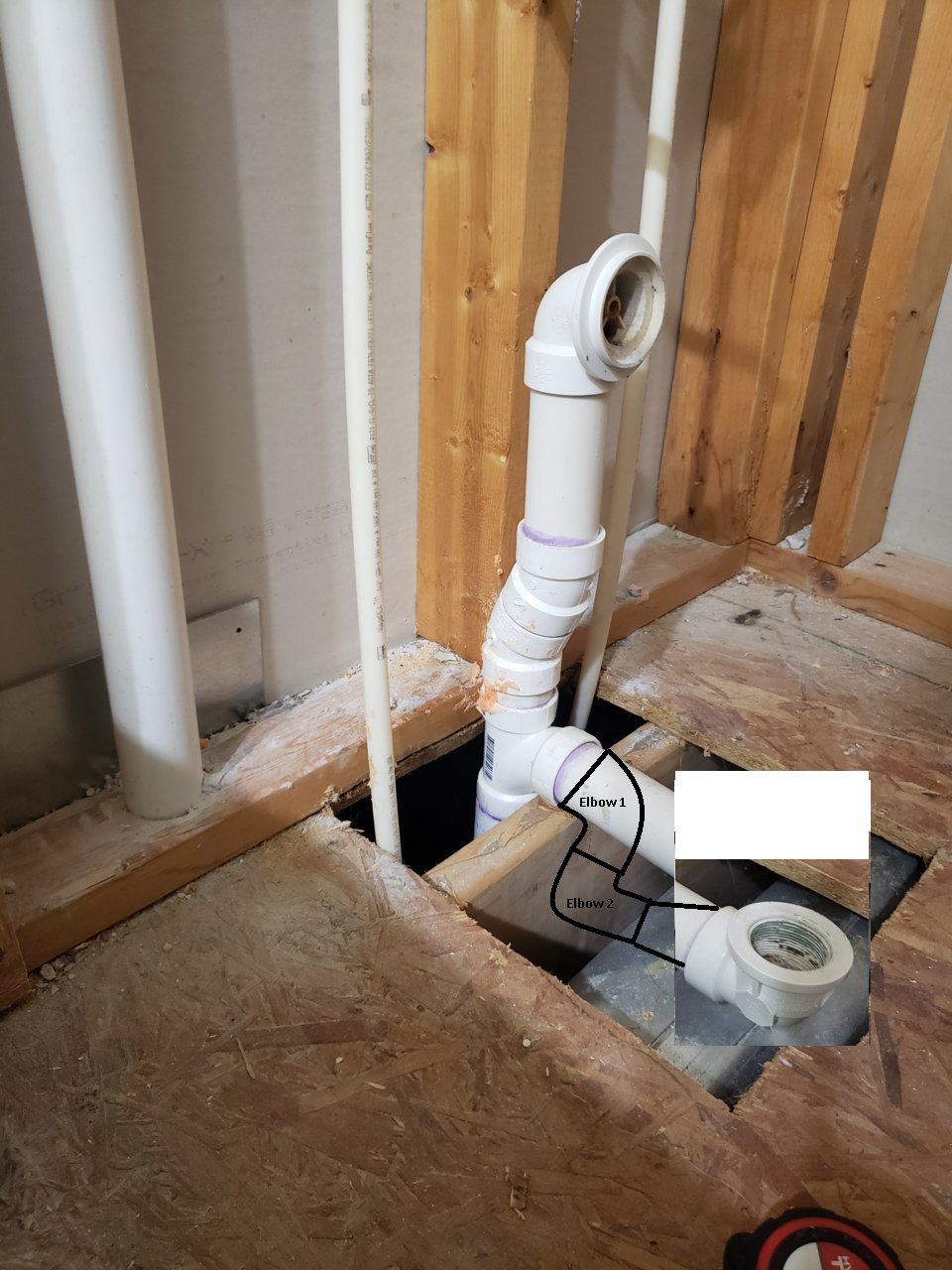

    I too had to make an account to try and help save you from stupid suggestions. They make "above the floor" style tubs that the skirt of the tub sits on the floor but the floor of the tub is raised to accommodate the drain being on top of the subfloor . That is what your old tub was and is roughed in for. I would recommend an American Standard Americast tub. Look at them online .

    P trap is on other side of joist

    I got ahold of a professional in my area, sent a picture and description ,and before i finished talking he blurted out "you need an above the floor rough in tub, i can get you an American standard by Friday...."
    So thats the route im going, apparently home depot and lowes dont even stock these tubs, hes getting it from a plumbing supplier.
    He also mentioned when he comes with the tub on friday if the current pvc drain pipes can be cut and reworked to fit the standard tub he will do whichever is cheaper.
    The above the floor rough in tub costs $200 more than the standard tub.
    Im not comfortable notching the floor joist, it is a long span between the support beams, the basement underneath is not finished so everything is in view.
    Thanks for all the comments.
