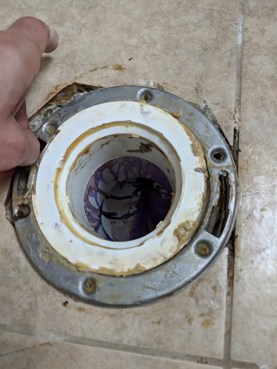

    If y'all have more time. I'm replacing a toilet. When I put the new one in it was rocking back and forth. Do I just need shims or does this stainless ring need to be secured to the concrete slab? Right now it rotates completely around.

    The flange should not be spinning. As far screwing it down to the concrete...I dunno. I’ve only dealt with sub flooring, not slab.
    Also, yea, the rocking comes from the tiles being different elevation. Just shim it.
