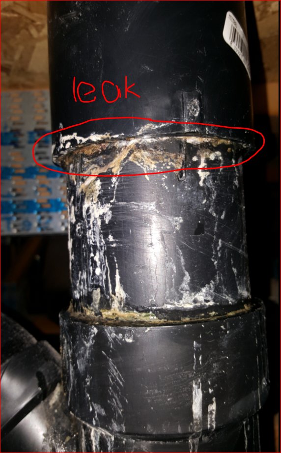

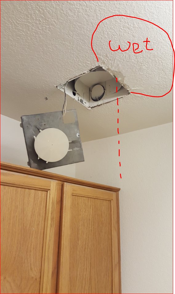

    Capture.jpg I wonder if I should rip into the problem (I can do plumbing) or call the insurance since will involve the dry wall repair/replacement also.
    The spare bathroom upstairs (formally of my daughter's) has not been used in a while but wife runs the water every few days to keep the water moving. She told me that the cloth dryer is wet and now I see water dripping from the ceiling fan but it seams it only drips when the water upstairs is running. Upstairs is all dry around the toilet and under the sink.
    Should I rip the ceiling and look/fix the problem or call insurance and have somebody come and fix it?

    Have cut a piece of drywall and it looks like is coming from the toilet drain (shit water:annoyed:) and felt the pipes and drains but the elbow looks wet. Will cut more drywall tomorrow and take pictures.

    I don't get it. The laundry room is under the upstairs bathroom and nobody used any of the tub/shower, sink or toiled many hours ago and is still dripping one drip every 3-4 seconds. From I could touch and feel tonight, none of the copper pipes are wet and the tub drain is dry, sink drain is dry and from I could see the toilet drain is dry but below where all join in the elbow is wet and drips. Where is the water coming from? Tub is not holding the water, sink is not holding the water and the water in the toilet is leveled to the bend and after that should not be any water. Why dripping still?
    Tomorrow with wife will move all from the laundry room, bring a ladder, cut the ceiling and look for water source.

    Ceiling under the pipe is cut off. Now just drips straight down.

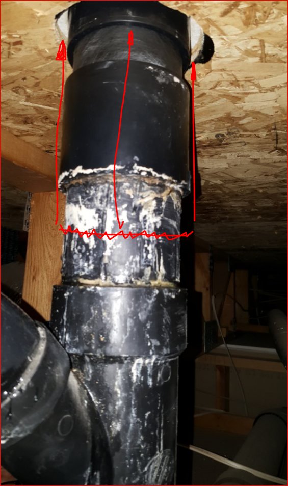

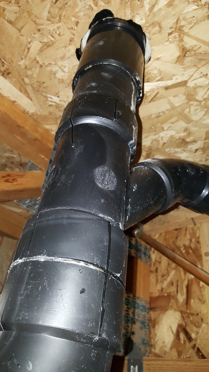

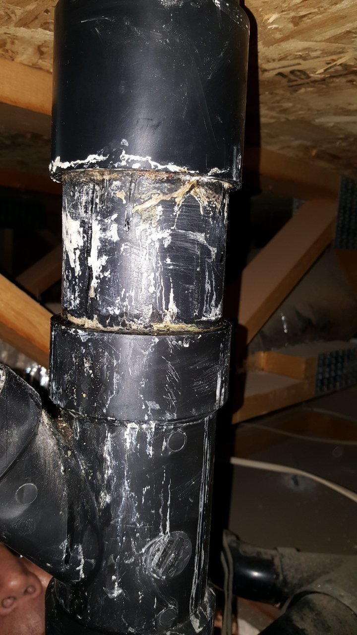

    Fixed it.
    From the upstairs bathroom/toilet.
    Front of the pipe visible from access hole.
    From the back of the pipe taken with camera phone.
    Have cut from the line up and replaced everything.
