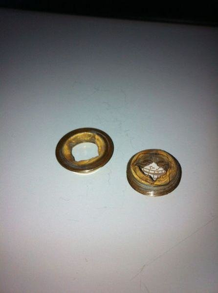

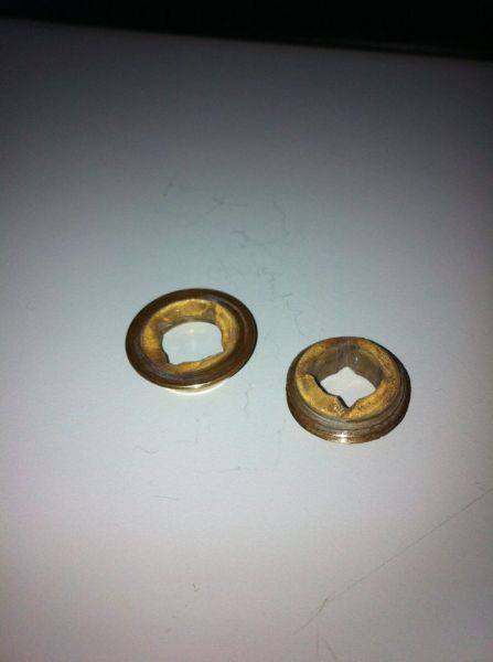

    It wasn't the wrong valve stem, in fact it wasn't the stem at all. It was the piece that goes behind the stem. I bought two of these little guys and 2 new stems which is why I was baffled as to why it was leaking since I had just put all new stuff in..turns out the brass pieces I bought was broken and thats why it was leaking...pics below of what it should look like and where it broke

    It's called a seat btw. The brass is soft and doesn't like to be over tightened. Not all plumbers get dirty. That's why I am a commercial plumber. All new clean pipe. New buildings are where it's at. Screw chasing turds and dealing with peoples dirty clogged pipes, for the birds. Fitters usually deal with steam or the guys that assemble the piping for refineries and the piping you would see in a beer manufacturing plant, etc.... Glad you got it fingered out. ;)
