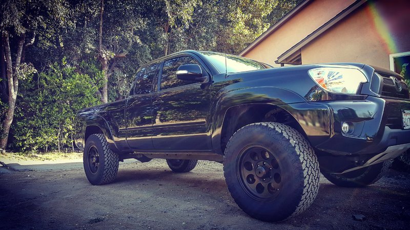

    15 TRD OR
    I have the same lift with 285/75/16 and I needed a cab mount chop and had to trim my fender liners. Sorry I don't have any pics of the trimming but here is my truckimage.jpg

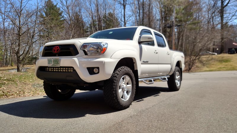

    19 dcsb sport cement 4x4
    I have the 5100/885's and 1.5" AAL. Here's a pic with ko2's in 265 70 17 c load. Rides smooth and no trimming needed.IMG_20160416_132642784_HDR.jpg

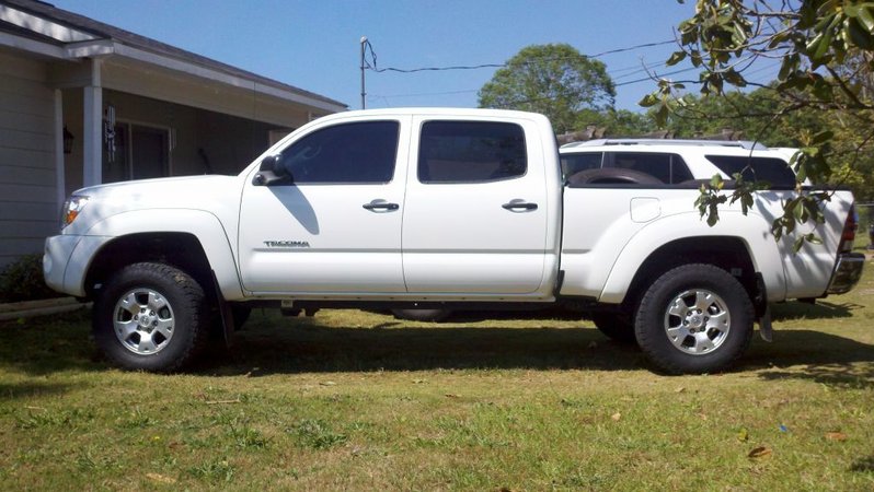

    ^ with stock Sport alloys

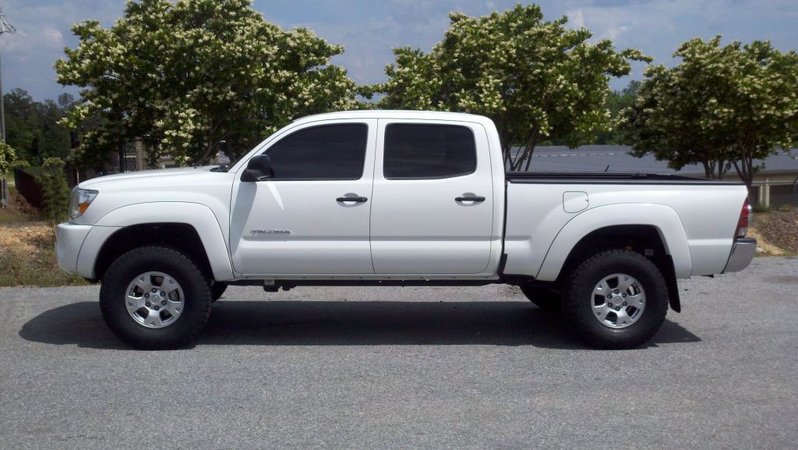

    They ordered 265's by mistake for mine when I had them put on and there wasn't much difference in stock size. I had them reorder the 285's and it looks much better with a full 3" lift.
    With 265's.
    With 285's.
