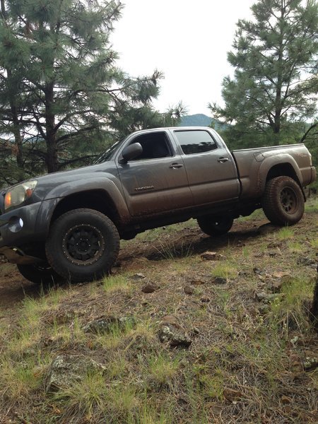

    I have the exact set up you want, except with Camburg UCA and Wheelers 3 Leaf AAL without Overload. I am currently running my 265/70-17 BFG AT that I previously had, but now on my new TRD PRO Wheels. I too want 285s, but everyone on this site says it will rub the UCA on full lock due to the 4mm offset not being enough to get the wheel out. I wouldn't mind running the 275/70-17 but BFG is a E rated which is too much for these trucks in my opinion.

  6. Aug 1, 2016 at 3:26 PM

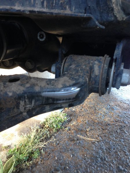

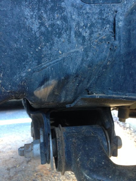

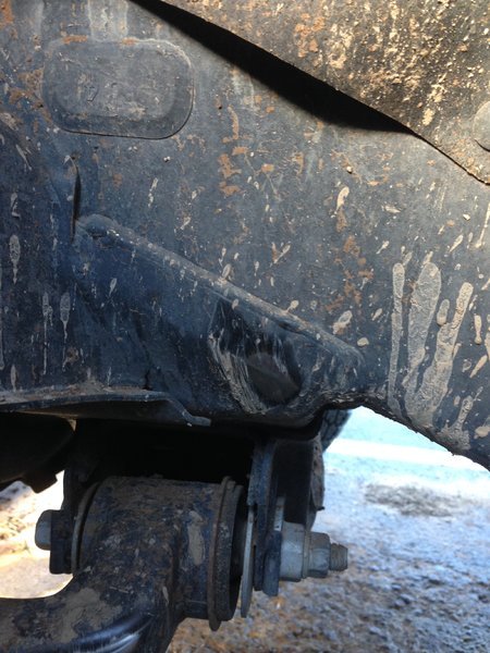

    I am running 285/70R17 and only have minimal rubbing on the LCA and frame from what I assume to be when at full lock and stuffed. No CMC and slight plastic trimming that I prob didn't need to do. IIRC the thing that can make a big difference from person to person is the backspacing and other specs on the rims. I can fix the rubbing by either different rims or spacers. It's not a big enough problem at the moment for me to do anything about it.

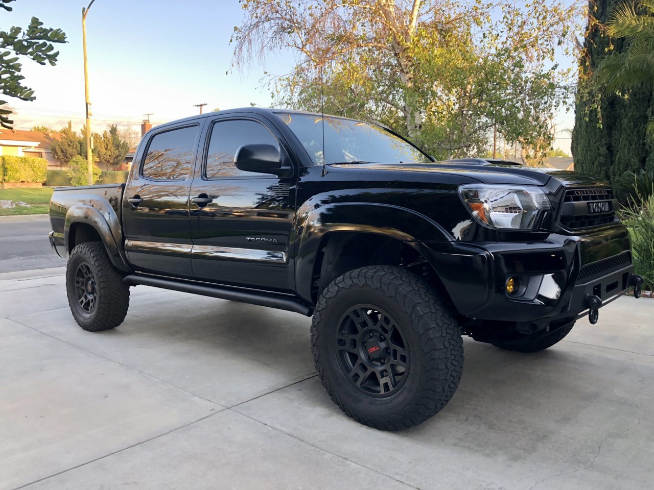

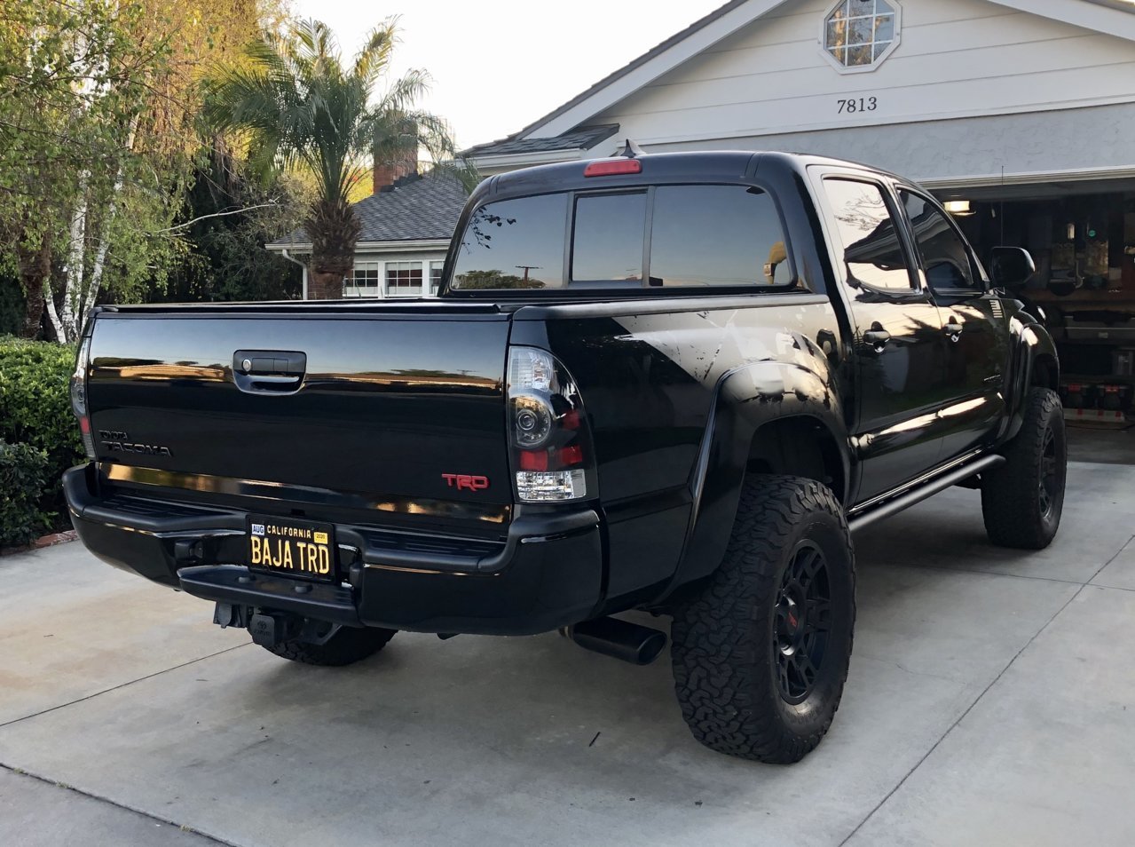

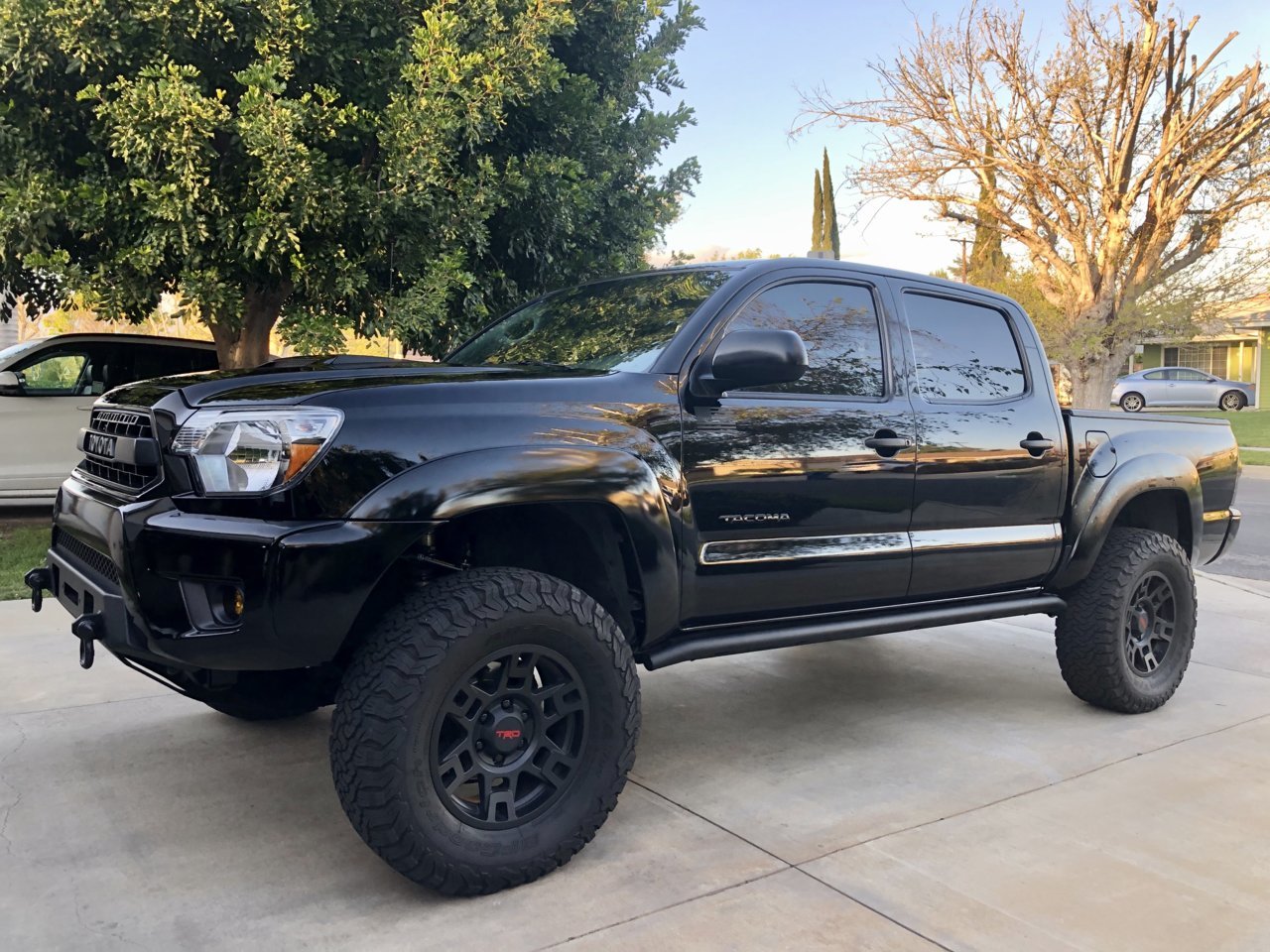

    I’m running 285/70/17 in the TRD SEMA wheels and I absolutely love this setup. Had to do the CMC, pinch weld mod, and trim a little plastic. Really not a big deal. Looks awesome, I constantly get compliments on the setup. Don’t hesitate, do it. And that one guy that posted he regretted it...that dude is crazy!! If you get BFG KO2’s, get load range C, not E. C rides much better.
    Also, I am running 1.25” Spidertrax wheel spacers and love the look, everyone does. Didn’t need the CMC until the spacers. My lift is a Icon stage 3, with the Icon RXT leaf pack. Also have the Icon UCA with delta joints.

    The CMC was not hard at all. Tons of people do them, takes a couple of hours. Well worth it in my opinion to run the 285’s. If you don’t run spacers, you probably wouldn’t need the CMC, I didn’t.
