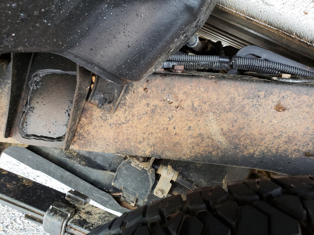

    Are the rockerbox seals what I see at the left edge of pic #5? Would the fact they've been left open be concerning?

    If dirt and road salt/brine are in rocker boxes and moisture is getting in it will cause rapid rust fron inside. I would remove a seal and check inside with a bright flashlight. You can remove those seals and spray Fluid Film inside using a 360 degree spray wand, clean outer surfaces and re seal with gorilla tape. There is an even better seal tape sold for home window installs but I dont know what its called. With the seals removed the rocker boxes can be hosed out and allowed to dry before FF.

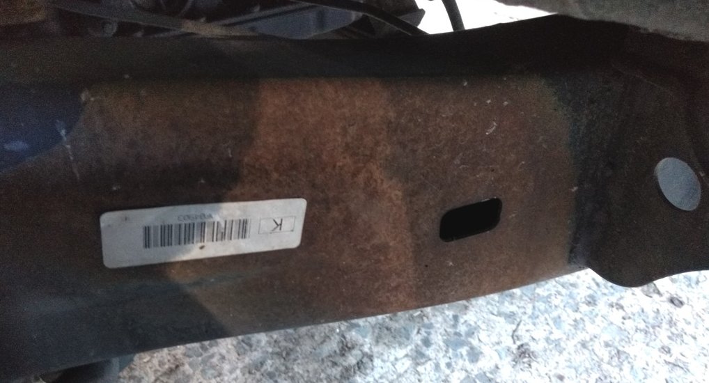

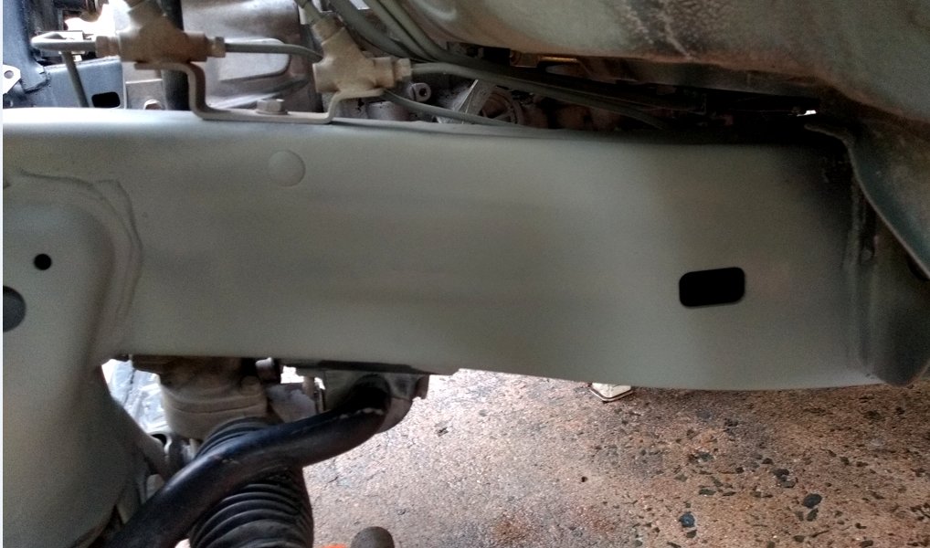

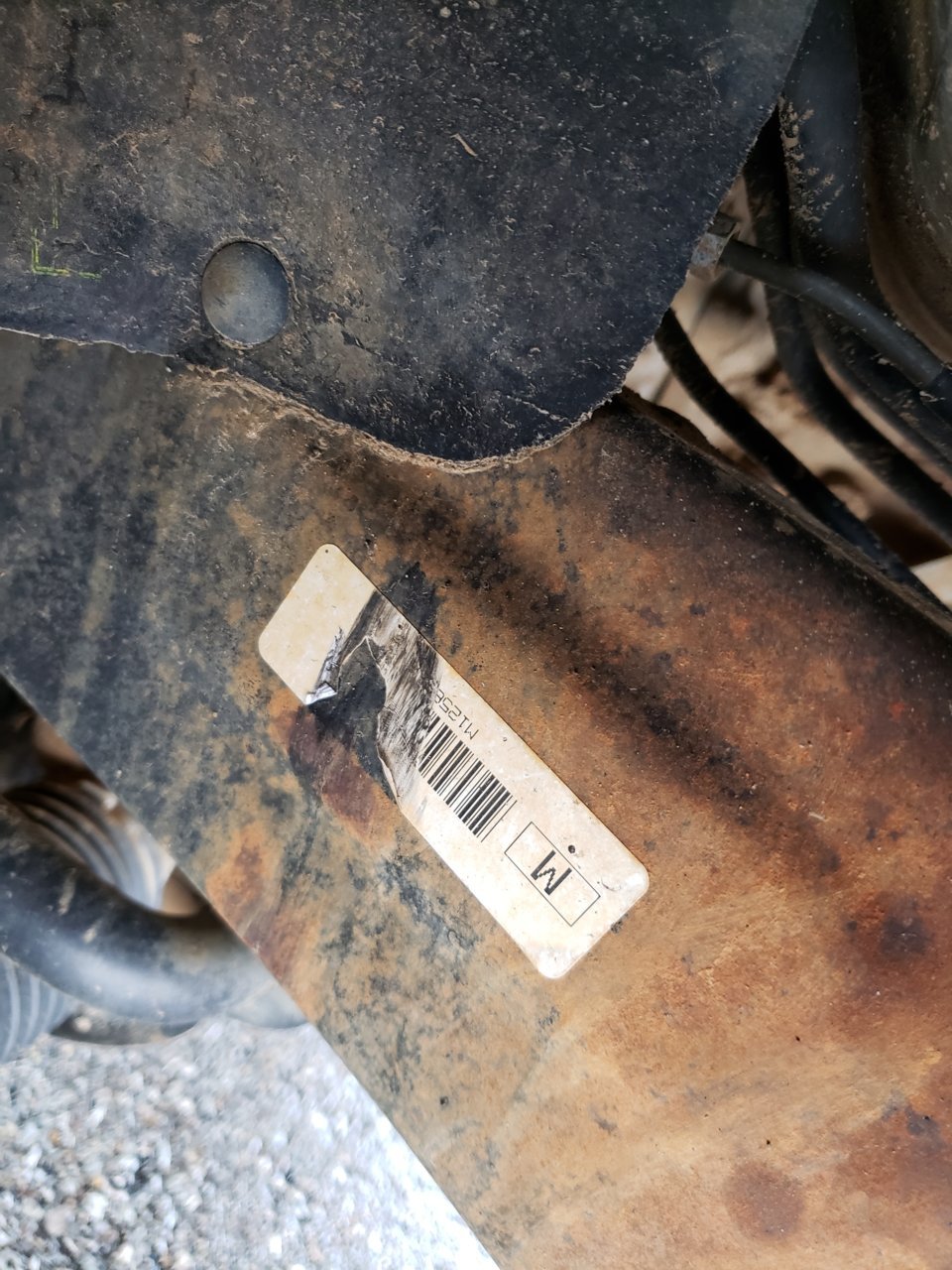

    I'm wondering why the dealership didn't actually "wash" under the truck. pure laziness or figuring no one would try to clean and see?
    I do see a rust spot in pic3 post #11 under the sticker at the edge of the frame. get a better pic of that from the side to make sure

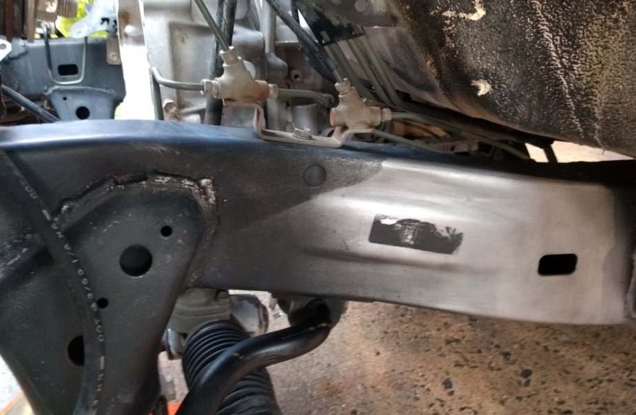

    Here are pics of the sticker with some surface rust nearby. The next pic is the frame above the driver's side rear wheel. The last pic is of the rear drivers side leaf pack.

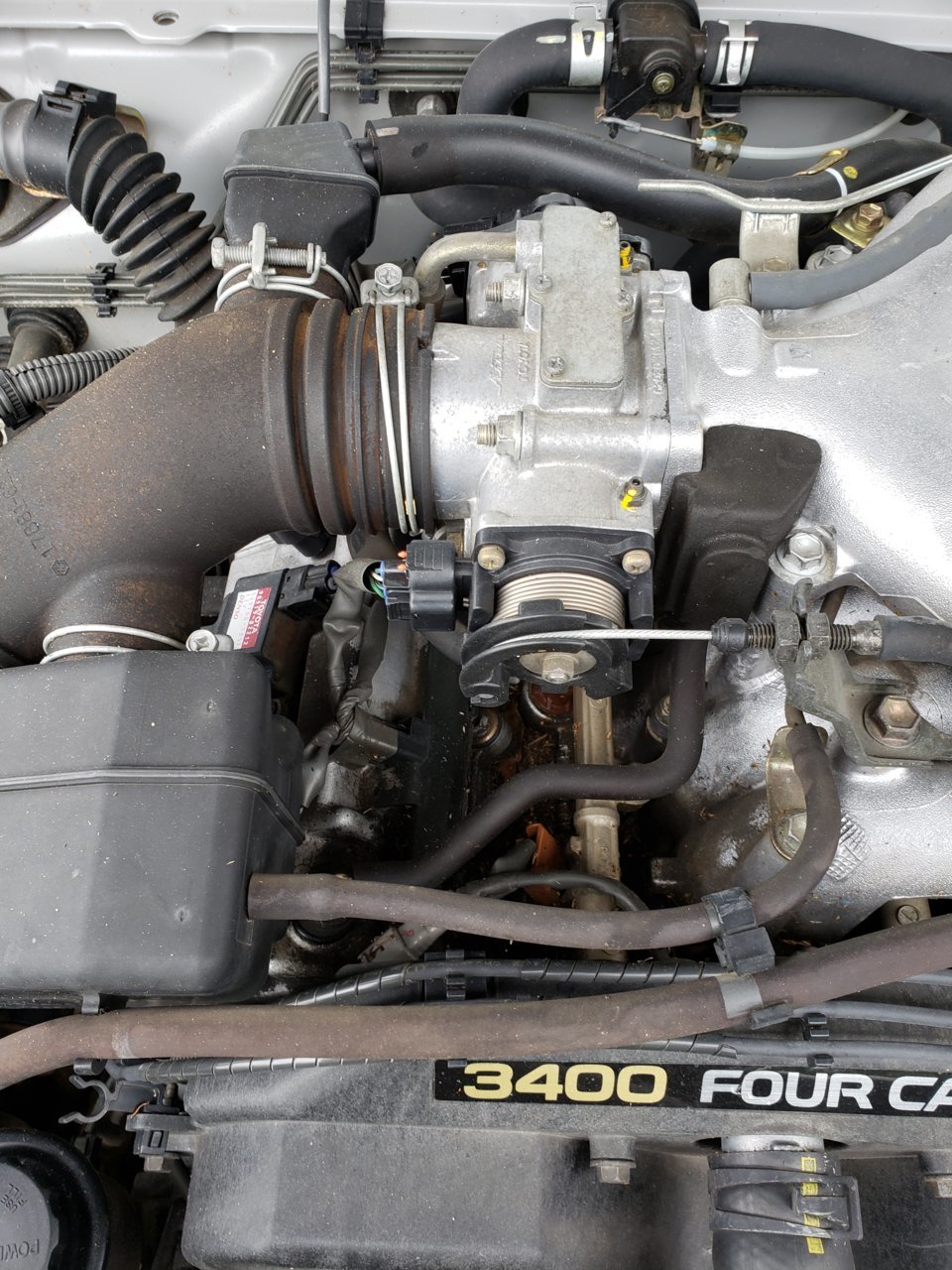

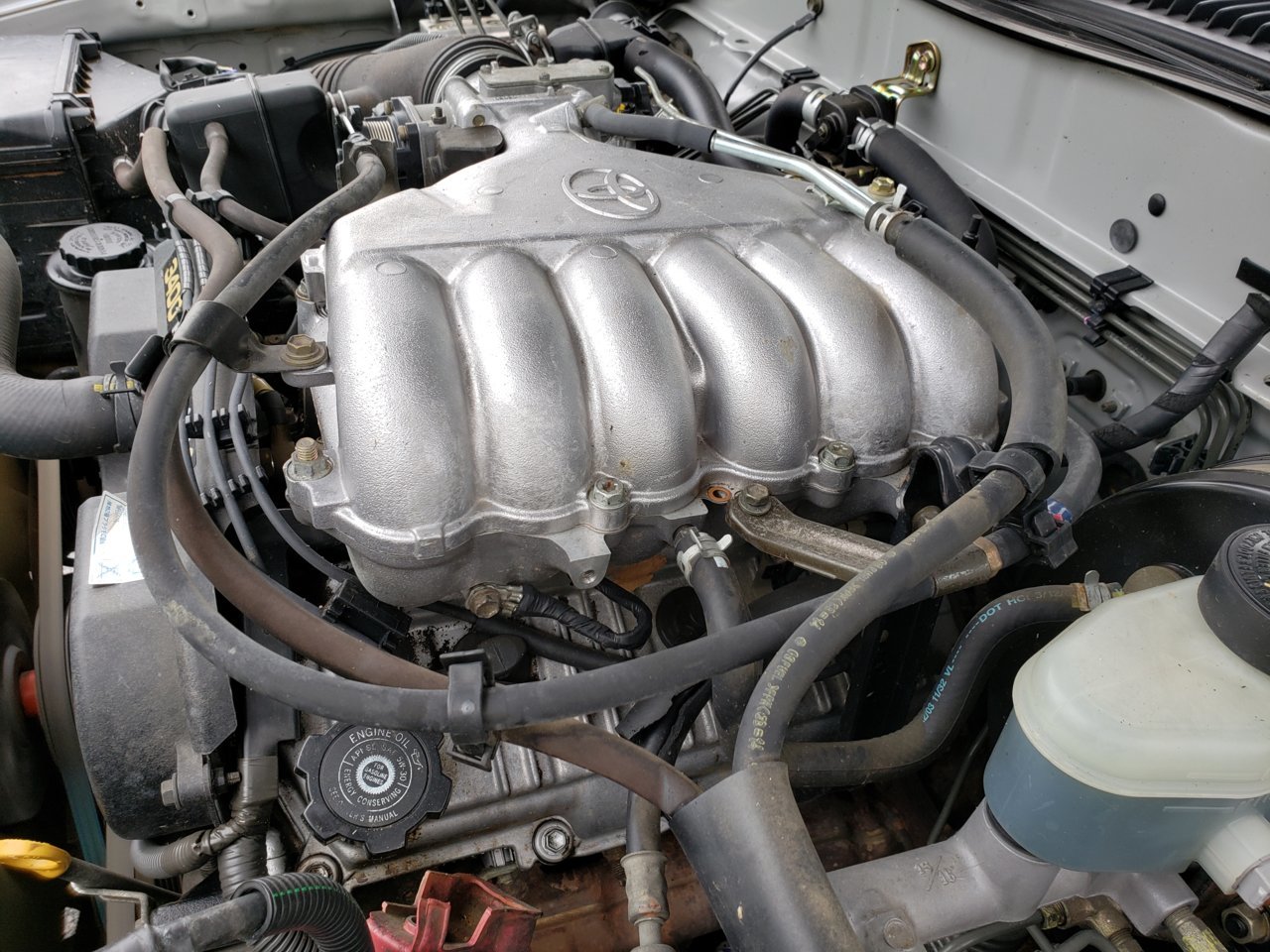

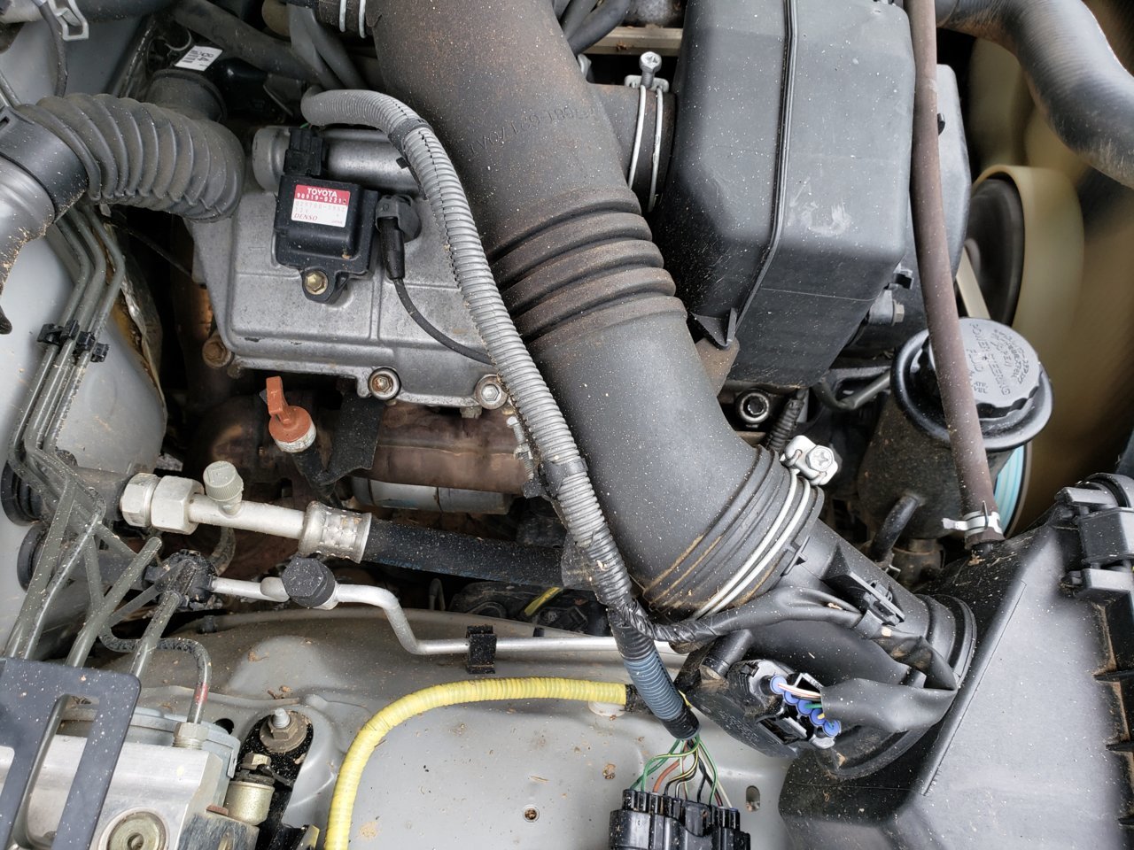

    Some engine pics. I dug around in some of the frame holes with my finger and came out with dry dirt. Its red but didn't look or feel like rust.

    honestly doesn't look bad at all, that's tire rub now that I see it, uniform "scrape" so-to-speak

    I dont think I would have an issue with buying that truck

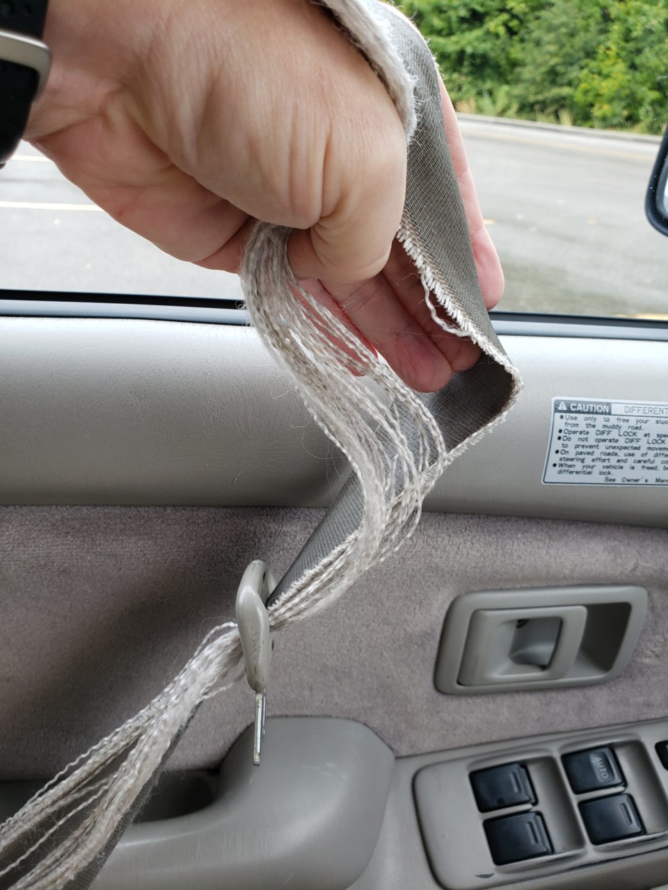

    Drivers side seat belt is in pretty rough shap . Easy to replace?
