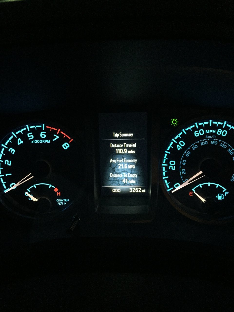

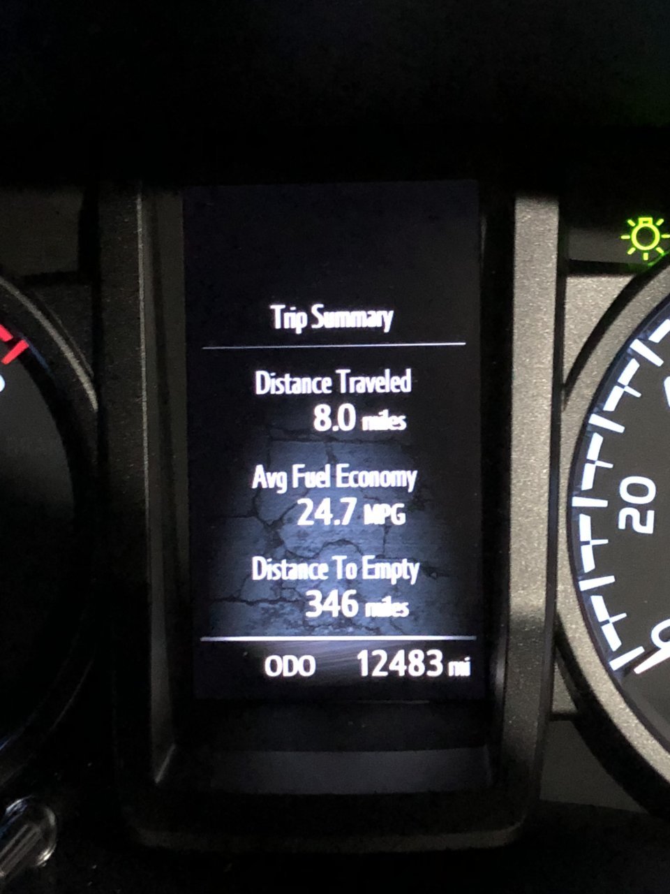

    An 8 mile trip really is not long enough to base fuel mileage. One downshill section will skew the results.
    This is post TSB for me.

    I already get that MPG(highway, 18-2 city) and that was before the TSB, and it stayed the same after.
    8miles is not good enough to do an accurate assessment, somewhere around 25miles it's more like it, although if it's all highway I suppose it doesn't matter.
