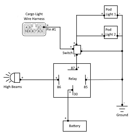

    The the two high beam fuses (under the hood) are only hot when the high beams have been turned on. It's an excellent place to push an add-a-circuit in and use that for the controlling 12v source to your relay.

    I'd wire it exactly how you posted in your first post - the hi beam power to the relay coil, the switch controlling relay coil ground, and then with one click of the dimmer stalk you are on low beam w/no light bar. I don't know about you, but I've met other vehicles off road, and wire my lights this way. You might be able to get you +12V hi beam signal from one of the hi beam fuses with a fuse tap, if the fuses are downstream of the dimmer relay like some vehicles - that one you'd have to check with a meter or test light.

    Also, just made this diagram for my own reference when I install the LED lights to turn on when high beams are one. I'll do write-up once all the parts get here.
    jkcashin[OP] likes this.
