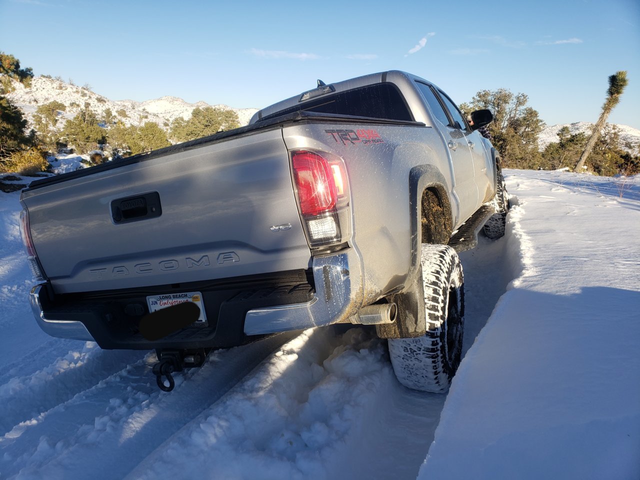

    I have 265/75r16 Falken wildpeak. Absolutely love them. Stock tires do not compare. Took a gas mileage hit 1-2mpg. If you do any offroading, yes get some.

    Is that stock suspension? how many miles did you get out of them? they look great...

    Have had the tires only 10k miles. 2.5" Lift.
    Truck is flexing to one side in that pic.

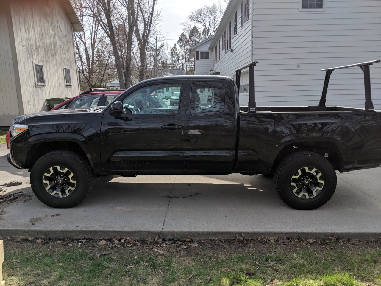

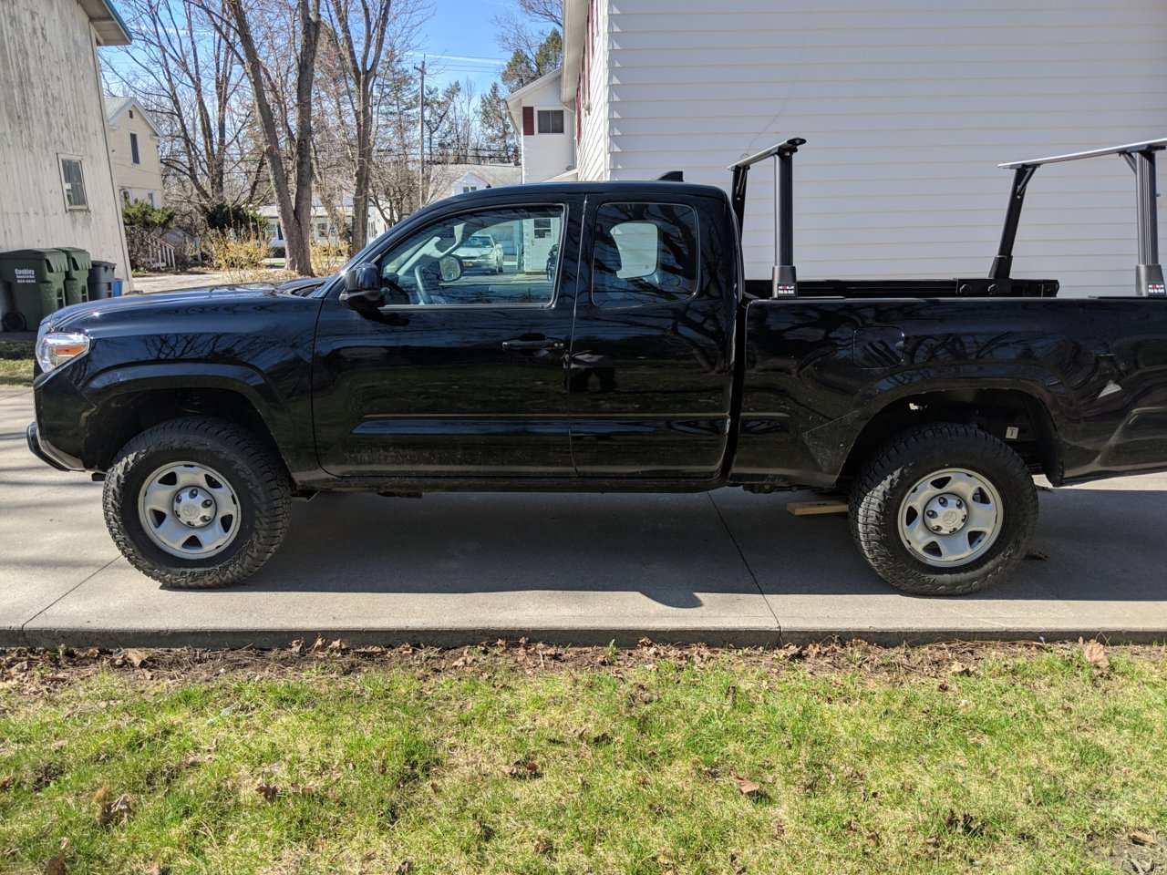

    So that is my truck, and last spring I got some 265/75/16 C load Cooper AT3s
    Before: 245/75/16 falken at3w
    After:
    The slightly bigger tires definitely look better, and difference in power is barely noticeable. My gas mileage actually went up with the bigger tires compared to the wildpeaks, but slightly down from what I was getting with the stock tires.
