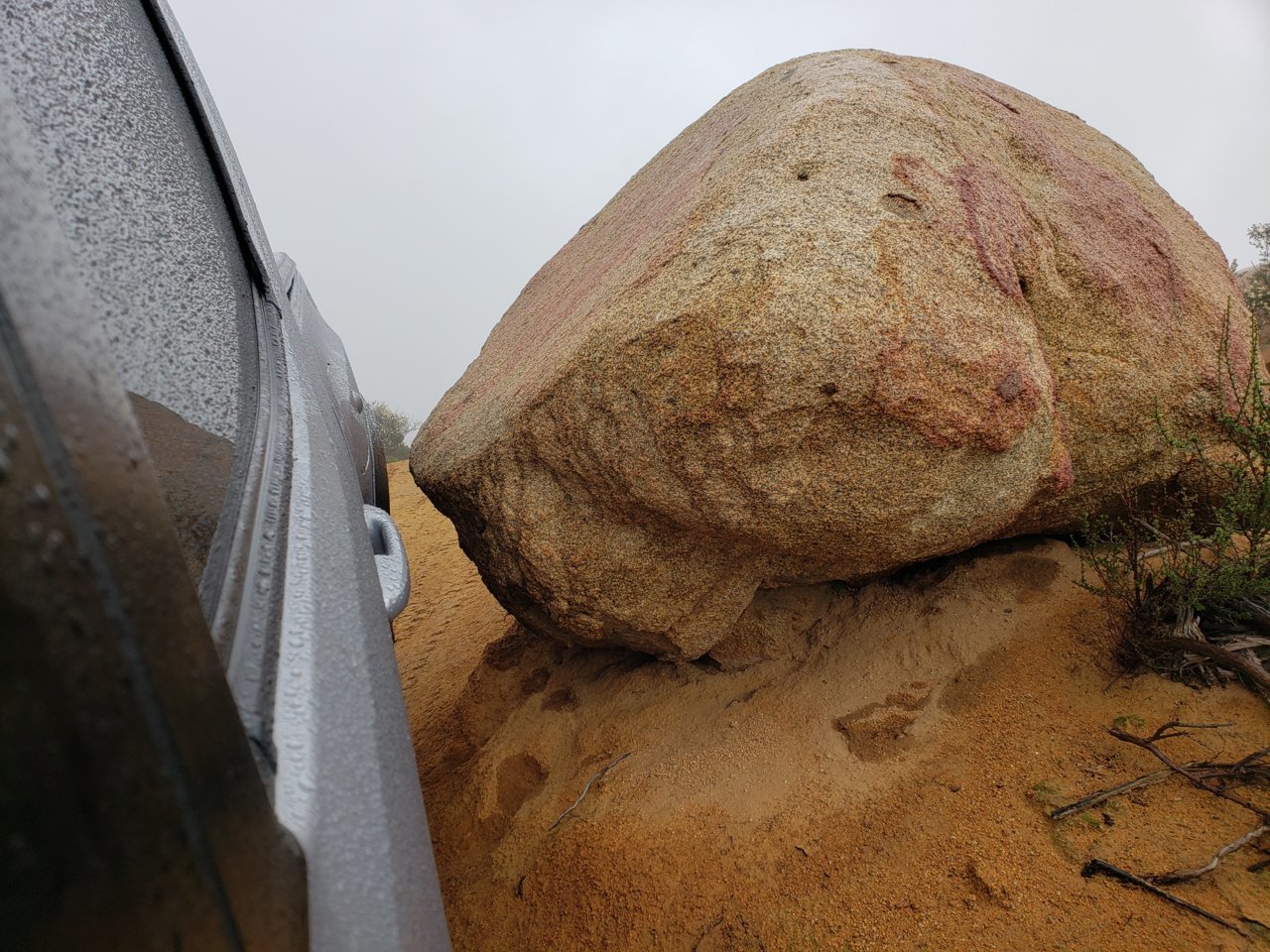

    lucky lucky man!! :boink:

    I was lucky here.

    I remembered going through a forest and hearing a big slammed! My right side mirror took a hard hit against a tree LOL! good thing it wasn't the opposite way!

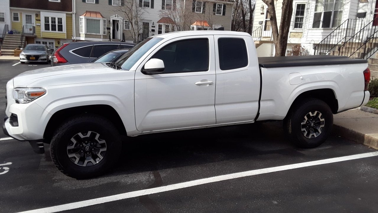

    Last weekend I switched my stock steel wheels and tires on my 2018 Access cab with 4 cyl motor.
    Found a guy who took the factory alloy TRD wheels/tires off his truck at only 400 miles from purchase to put on monster wheels/ tires and a lift kit.
    Had them sitting in his garage since 2018.
    My original tires are Hankook 245 75R 16. The tires on the new TRD wheels are Good Year Wrangler 265 70R 16 and to be honest I can't tell much of a difference in power but do feel like the truck went up 2" in height.
    Always take the same route to work everyday and when I shut off the motor it says 7.7 miles but today it read 7.5 miles.
    I really like the look of the bigger tires and new TRD rims over the steel wheels I did have.
    Here is a Pic from last Sunday.

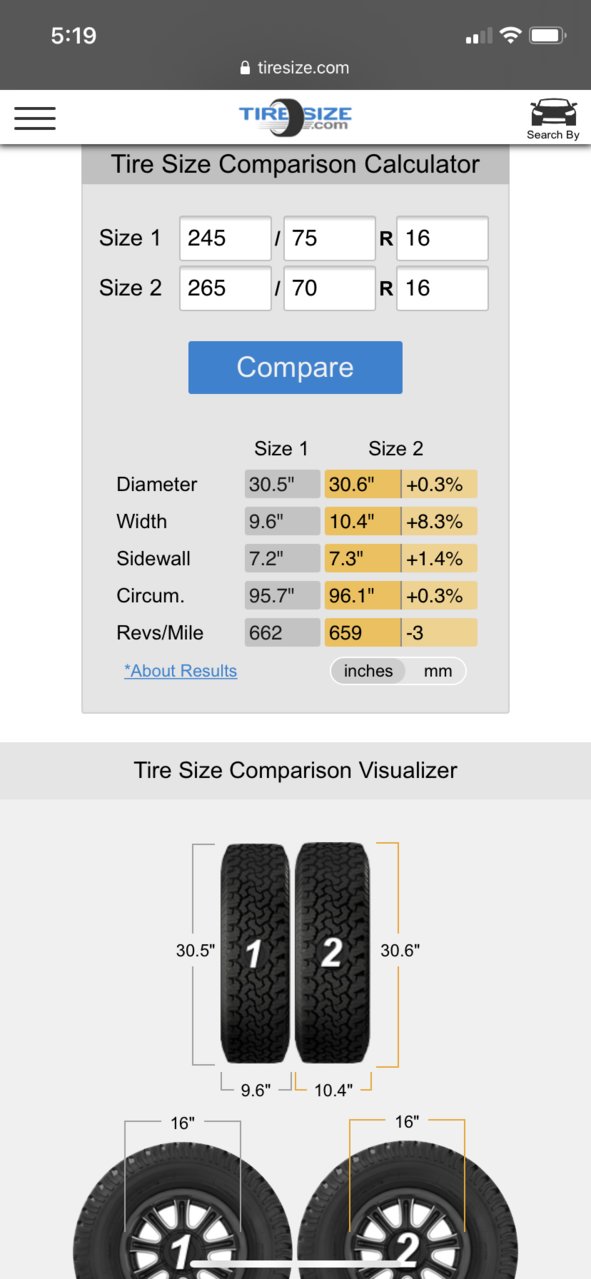

    Hate to break the news to you but the new wheels and tires are almost the exact same size. You also did not get 2” of lift from them. You would need a 4” bigger tire to give your truck 2” in height.

    265/70/16's are the same overall diameter and height as 245/75/16's. They are just 20mm wider. That is an optional factory size on many Tacoma's. A 265/75/16 is about 20mm wider and about 1" taller than stock and I think a good compromise. That used to be the factory size used by Nissan on their Frontier and X-terria before they dropped down to 265/70/16.

    Must have just been my perceived perception of the change. Obviously I never measured anything. Clearly the width was the biggest change.
    No question that 0.1" increase in tire height has affected my odometer to about 2 tenths of a mile every 7.7 miles.

    His stock tires were 245s.

    You almost scraped the only rock on the beach.
