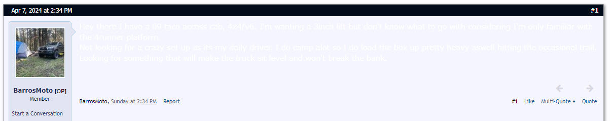

    Am I the only one who is seeing this as all white text on a nearly white background? Stop using white text, nobody can read it, my eyes are bleeding. Screenshot below to help demonstrate.
