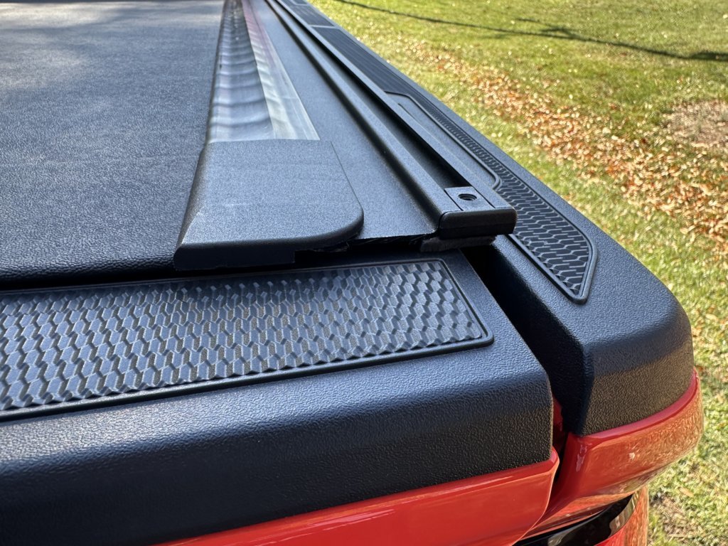

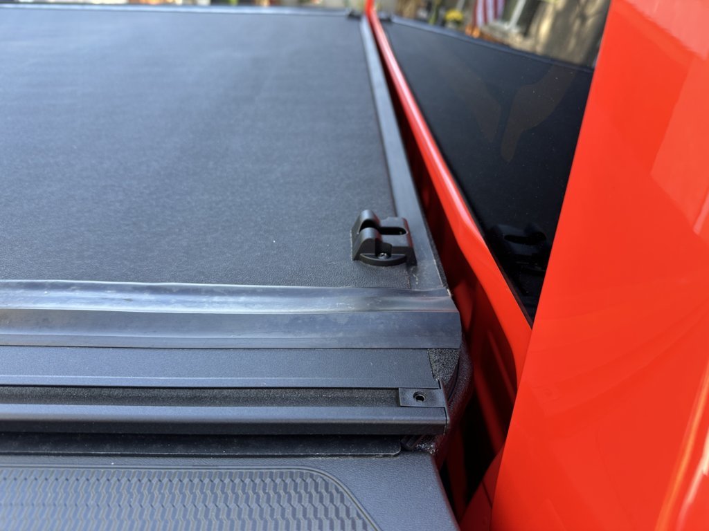

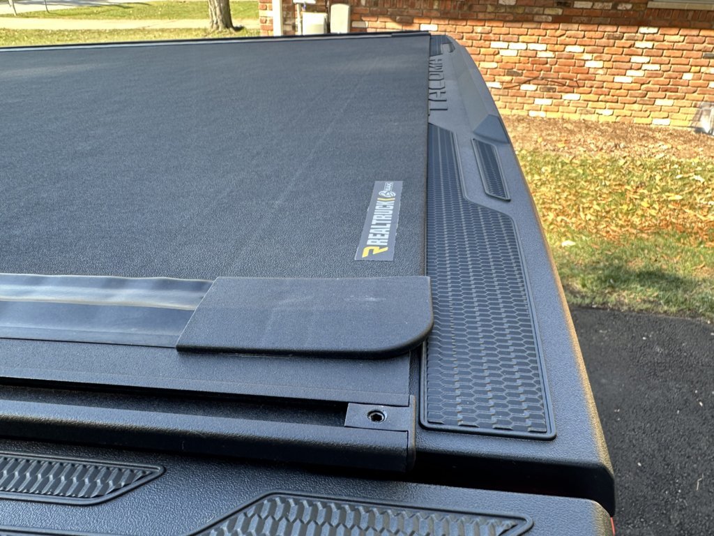

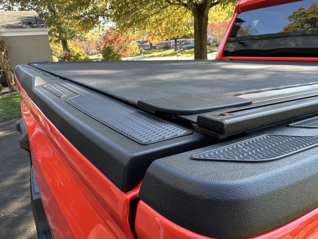

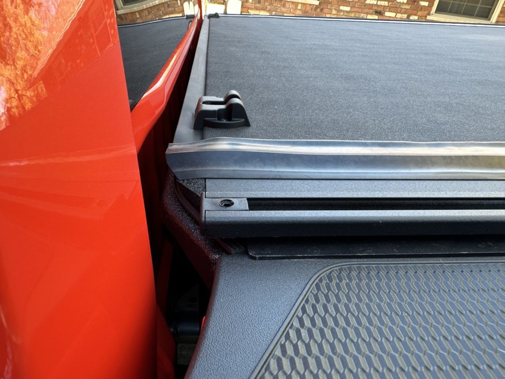

    Bakflip Revolver x4ts

    LouDawglll, you have the best photos of that tonneau cover I've seen. Do you still get to use your inner bed rail or does the tonneau cover them up?

    Yes, the OEM side rails are still accessible; however, that comes with an “asterisk”. The OEM rails remain in their factory location and the Bakflip X4TS supplies a bracket for each side of the tonneau that adapts the tonneau’s side rails to the OEM bed rails. When mounting this system, there are three fixed connection points and there is no flexibility with these mounting locations. If you have other accessories (ie bedside molle panels, etc) that also have fixed mounting locations you could have compatibility issues. Individual bed hooks work just fine … As you are installing this tonneau you have to do a little pre-planning with how you intend to utilize the rails and slide in t-slot bolts for this accessories as you are installing the tonneau. I’ll take a few more photos of the rails later this evening for reference.

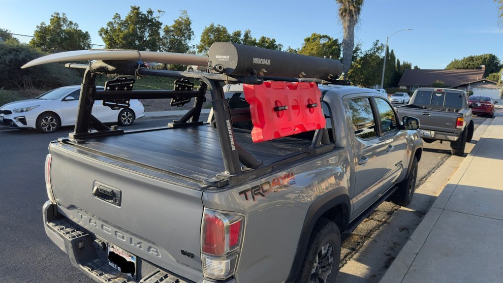

    I've loved my Retrax ProXR and Yakima rack as they've been super versatile together. Wasn't cheap but worth it.
    I'll be removing/selling them to go the wedge topper route in January. If you're around SoCal and the retrax cover fits on your 4th, I can give you a solid price for the pair.
