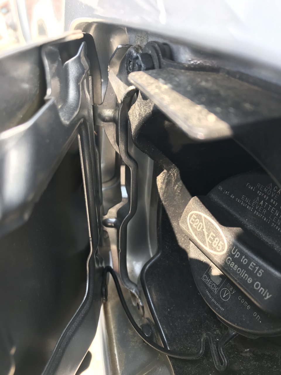

    In any case I decided to take a look at the fuel door. It appears to me that the design of the gas cap cord when oriented up could allow it to be caught on the door hinge point as you close it, jamming it against the metal as show in the pics below. Being right at the hinge point the door would act as a fulcrum placing a lot of pressure at the hinge with the cord jammed in there and possibly damage the hinge/door joint.
    So it’s best to ensure the cord is oriented down to ensure it’s not trapped at the hinge point.
    A better design would take human factors into account and not connect the cord to the door at all but attache it to the bunghole on the right side. Accidentally trapping the cord on the right side of the door would prevent it from closing but wouldn’t put near as much pressure at the hinge joint.
    Another option is if it’s to be attached at the door, provide a guide or fix it in place to ensure the cord is always oriented down. That’s the engineer in me talking though.

    I agree.
    Since I know it's a potentially flawed design I take the extra second when closing my gas door to make sure the wire isn't in the way.

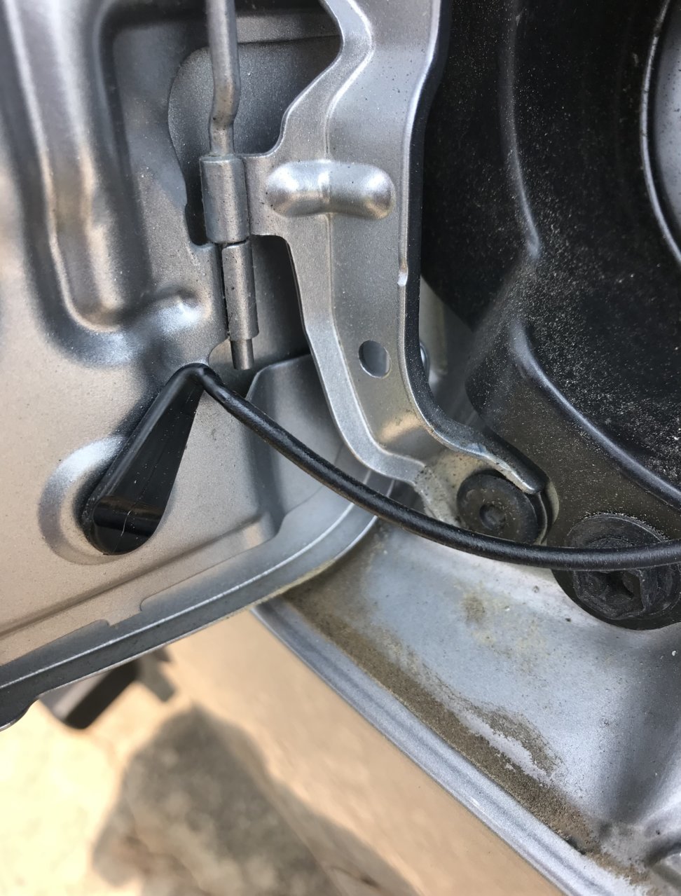

    I have always struggled with the placement of the gas cap tether when closing the fuel door. It has wreaked havoc on my anal retentiveness. I have therefore come up with the gas cap tether relocation mod.:) I did have to use a drum sander on a Dremel to slightly reduce the radius of the retainer on the end of the plug that goes through the hole because the hole is slightly smaller than the one on the door. I did this on both of my Tacoma's with no problem.
    If you decide to do this just be careful while removing the end that is in the fuel door. Pulling outward and twist while doing so seemed to be the trick for me.

    Hire this man Toyota!!
    Bro this is an awesome fix. :thumbsup:
