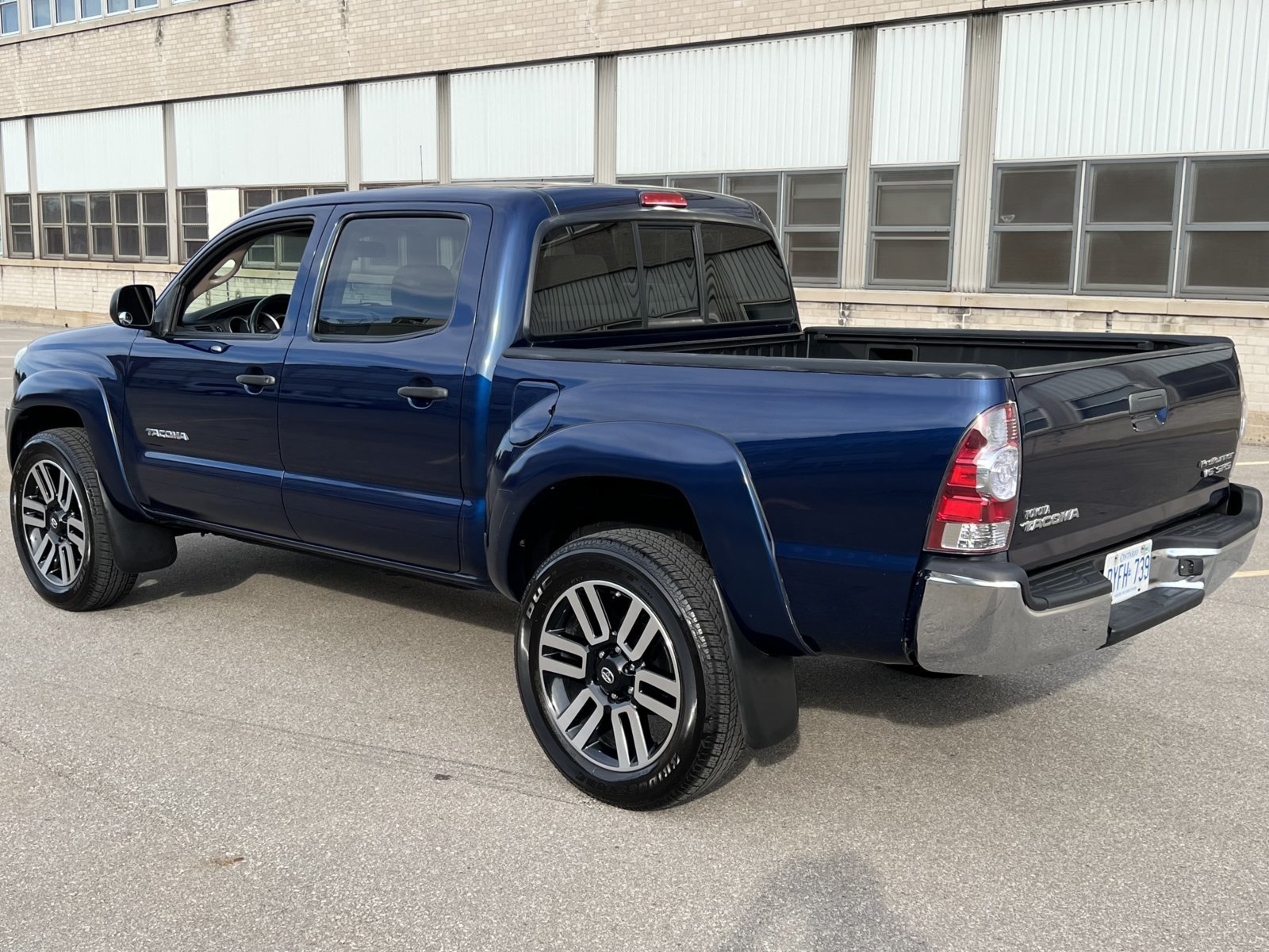

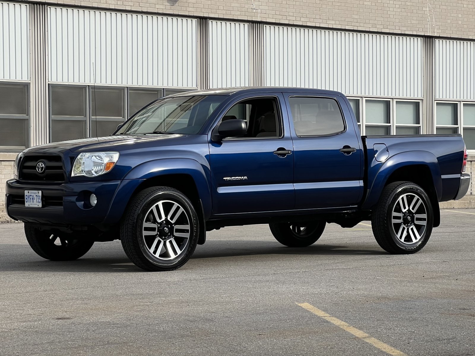

    You should paint match your grill. I’ve always liked the 09+ LED OEM tails with the blue.
