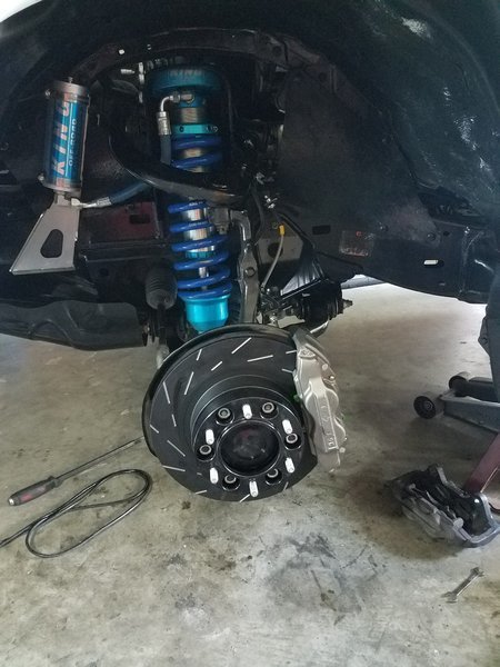

    I'm running ebc slotted rotor, ebc green pads and stoptech brake lines. Feels 10x better than before with hawks and stock rotors

    They made a pretty big difference over stock. Released a lot of brake dust, but I have heard mixed reviews about them. Never had any issues but it may have been that I have a regular cab so i didn't have all the extra weight. Originally I went with the hawks because I ran them in my DSM and was very impressed. but having both pads I would definitely go with the ebc's

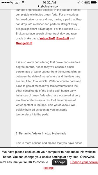

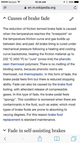

    Dude you guys have some seriously fucked of theory's on how brakes work... when you heat up pretty much any element to the point of it essentially evaporating you're going to get a gas as at very least a by product. This is what happens when you are using your brakes for pretty much anything over a casual stop at the light. This is why it is beneficial to run a slotted rotor. U keep gas, dirt, and other contaminants off the contact surfaces of the rotor and pad.
