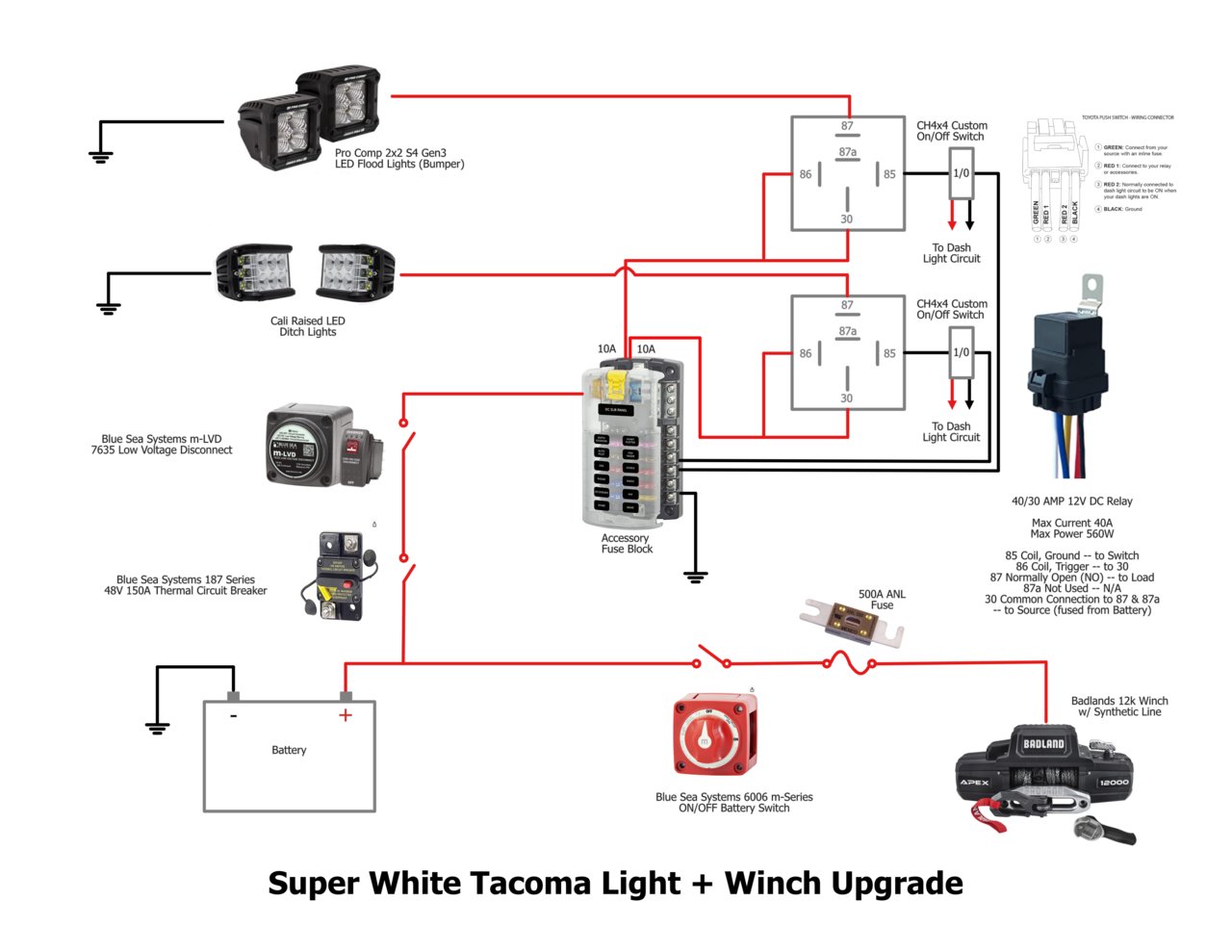

    Question for those of you who have mounted devices to the stock relay/fuse box cover: do you have any regrets doing this? I am considering mounting the m-LVD feeding the aux panel and the ON/OFF switch for the winch to the fuse / relay box cover and have seen others use this method (@Manwithoutaplan example, @12thmanhawkfan example, + there are others).
    I'm looking for compelling reasons not to mount them here; I am pretty sure the stock fuse/relay block will be the most efficient use of space for these two, bulky pieces of gear. What say you?

    Space is an issue. I have an overland engineering panel with the breaker and an aux fuse panel and room for the m-LVD rocker switch and space for the relays but not the big, bulky switch and m-LVD box. I have seen custom battery boxes where people have mounted accessories to the front of the custom battery box setup since there is space between the battery and the driver's headlight.
