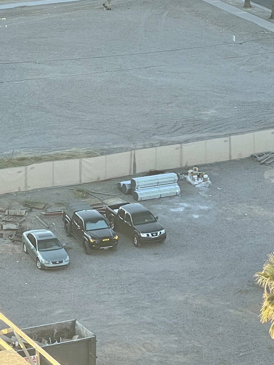

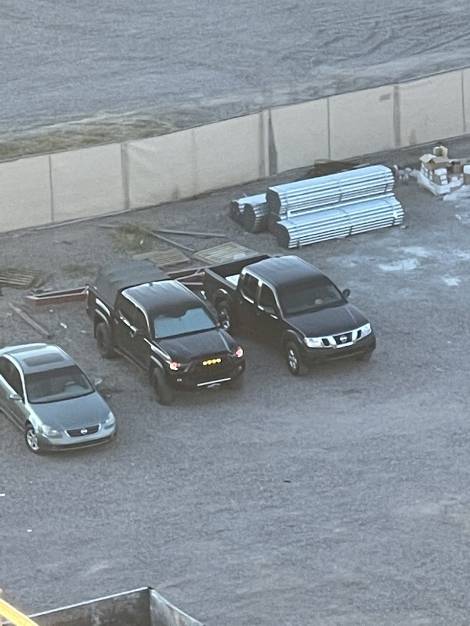

    Parking brake won't help unfortunately. This is my truck now with the brake up.

    It's funny you mention that. I think I happened to snap a pic mid lock :eek:.
    Here's white with the red halos.
    PvilleJohn[QUOTED] and Junkhead like this.
