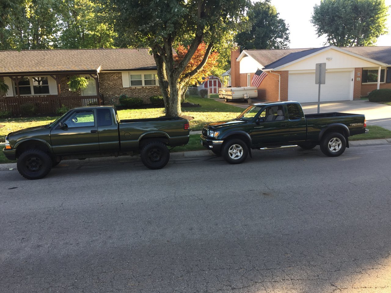

    Looks A little small compared to my s10. Tacoma is pre lift in pic. I should have been in the Toyota game a long time ago! I'm loving it! IMG_0897.jpg !
