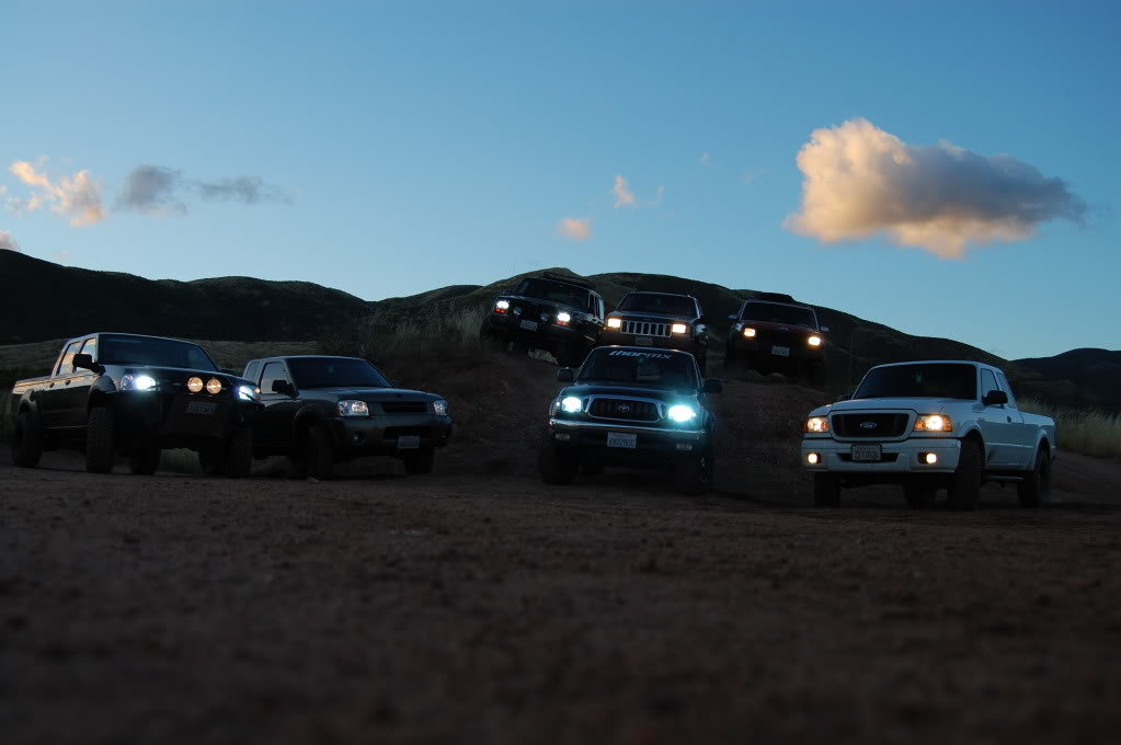

    taco in the middle, 10,000k 55watts. 55watts flushes out the color a little though, if i had 35watt ones theyd be bluer but less bright. if that helps...

    Then you'll need a projector retrofit. The reflector bowls are not designed for HID systems and the light tends to scatter.
