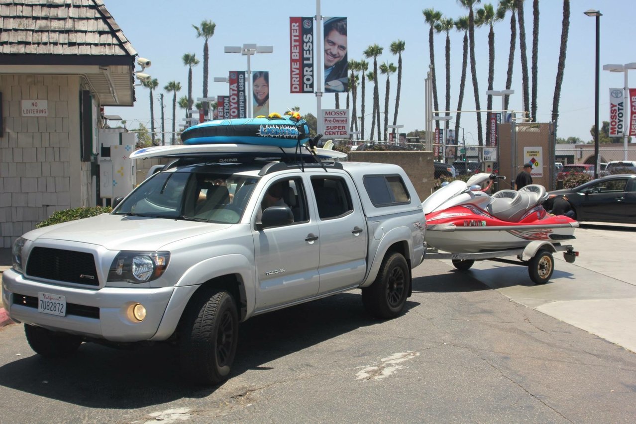

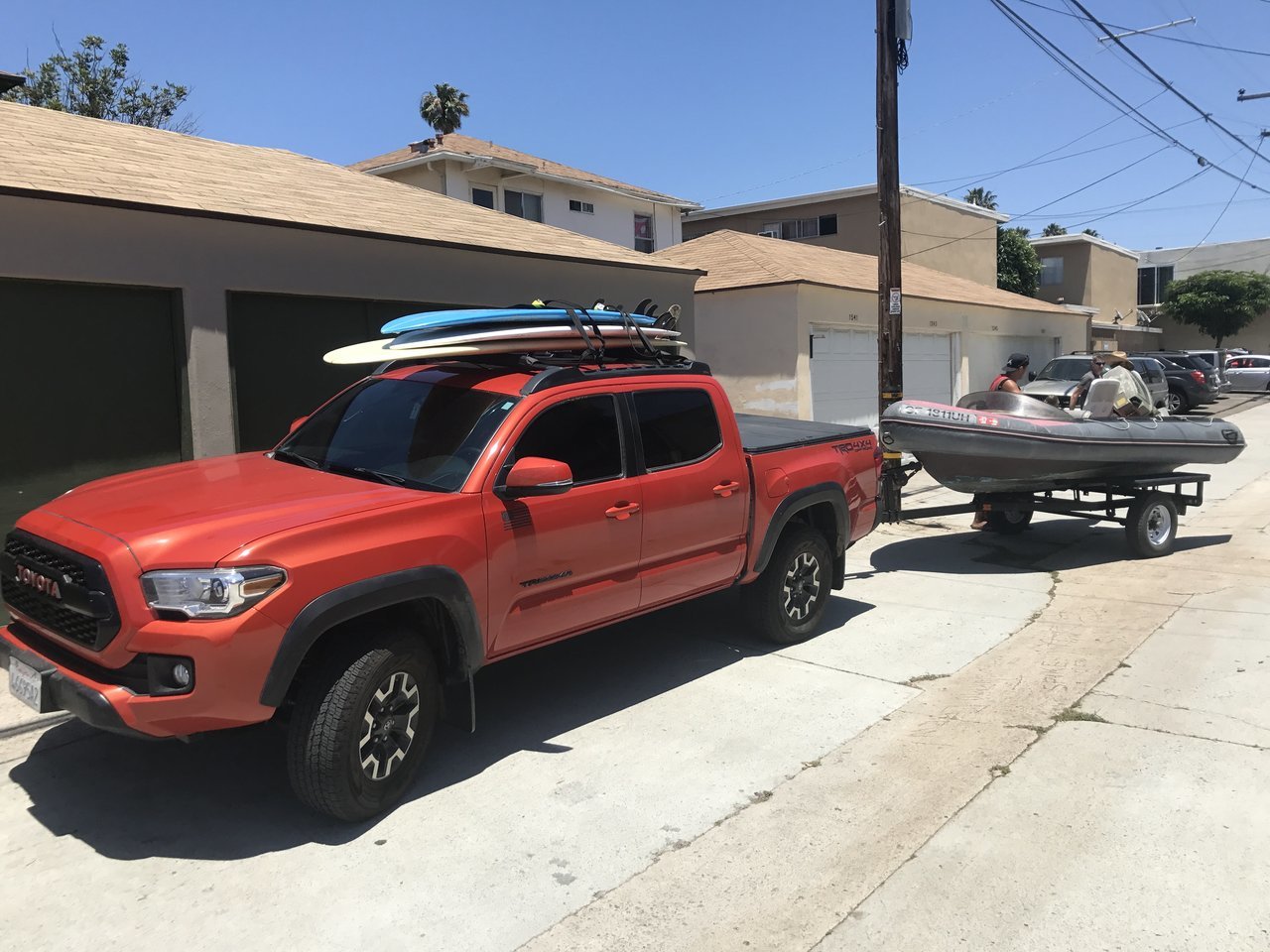

    I actually really like the OEM rack, I use some old offbrand ski holders that work fine for my 170cm skiis and 160cm snowboard.
    I've loaded up 100lbs worth of paddleboards/surfboards/kayaks etc... one time even put 160lbs of cargo basket and gear and offroaded with it, technically overloaded but it did great.
    In my experience the OEM racks are actually the QUIETEST at highway speeds plus in my opinion they just LOOK a lot better. I like keeping as factory look as possible, I call my mod style "OEM plus" so I like a nice OEM look that flows. Other racks just look out of place to me but that's just a personal opinion.
    I'd of course love the extra capacity of a rhino rack but the additional cost is just not worth the additional load capacity for me right now. So far the OEM rack has handled everything I've thrown at it.

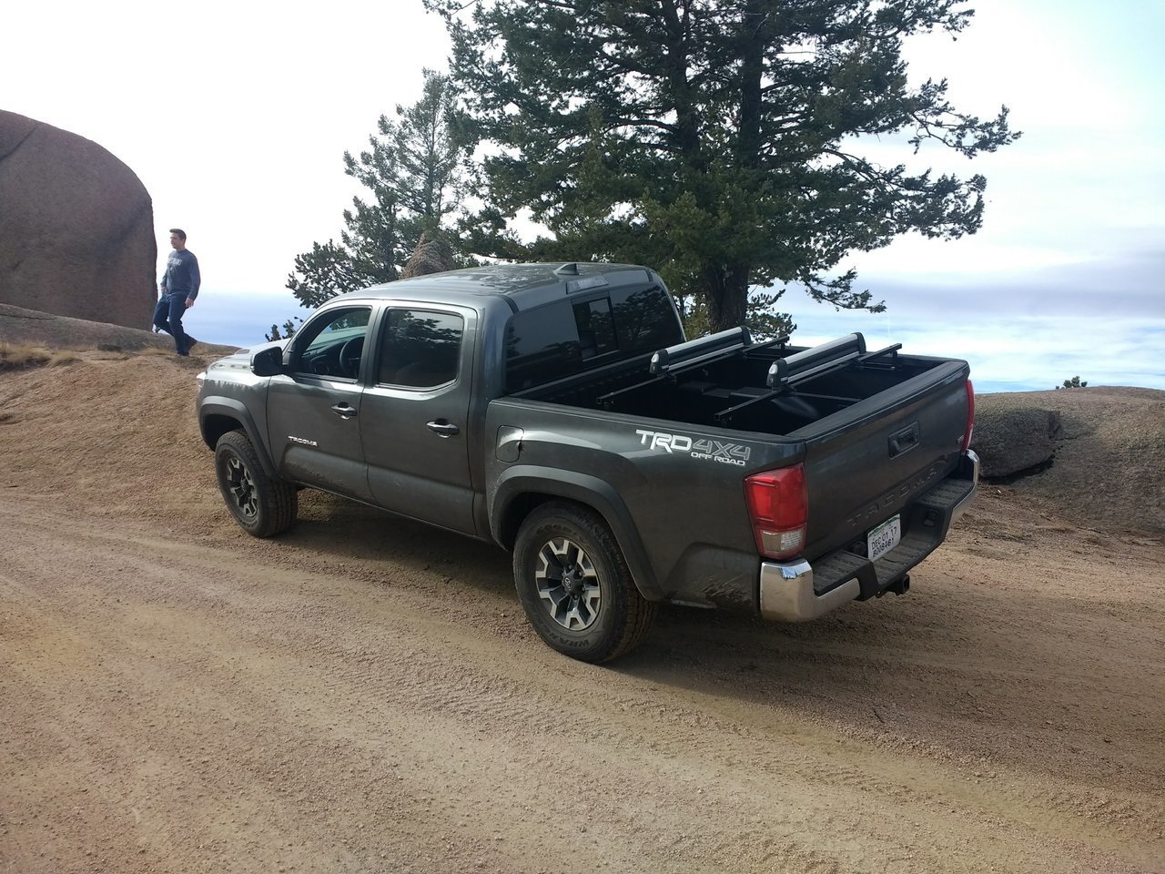

    I took some 5' lengths of 1" x 1" square tube and bolted it to some 90 degree bent 1/8" x 1" x 6" bar. I bolted the bent bars to the sliders on the side of the bed. I attached my thule ski rack to that and it has worked great.
