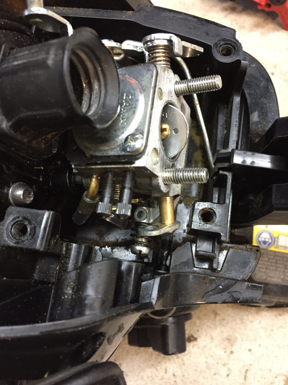

    Looks like their is 3 adjustment screws. One for the idle. And a High and low.
    Disconnected the carb and when I pull I hear a suction sound. Is that normal? Can’t tell if ya coming from the carb or the cylinder

    Noise is coming from the carb. Purge bulb is suppose to take the air out. Wondering if a gasket is taking a shit. Guess I’ll open it up and see

    I took the carb apart and clean it. All the gaskets and diaphragm were good. No build up or anything I could see. Saw only was ran maybe 2-3 hours at most.
