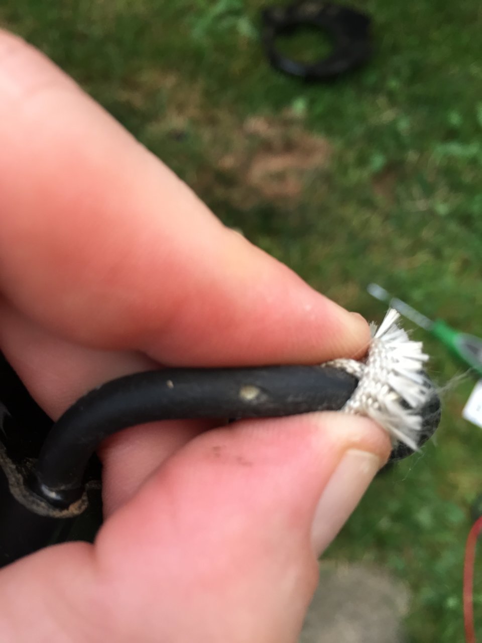

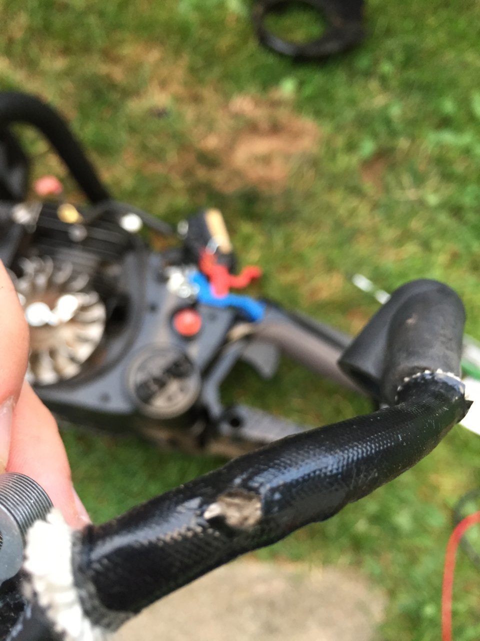

    Not sure if this is the original cause but the mesh cover that protects the coil wire was chaffed. I slide it back and there is a Knick in the coil wire. Pretty sure I did that trying to tuck it back taking it apart last week. I didn’t see any wire and it still looked good but when I put my fluke on it I was able to get some impedance so it’s telling me there is a slight hole and that could definitely mess with the spark. So I’m gonna order a new coil. If that doesn’t work I think I’m going to admit defeat. This damn saw has taken some of my blood and a lot of sweat. I’m not giving it any tears!

    Damn, and here I thought Echo stuff was pretty decent. I thought they made their stuff. Well if I ever get a another saw, Stihl it is for sure.
