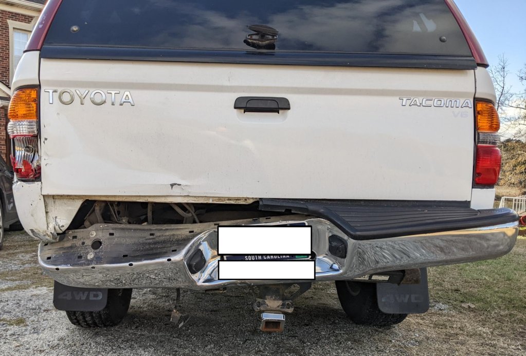

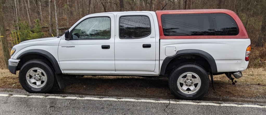

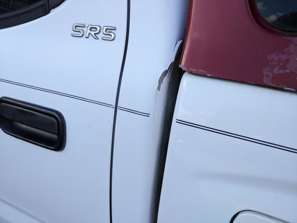

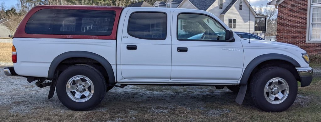

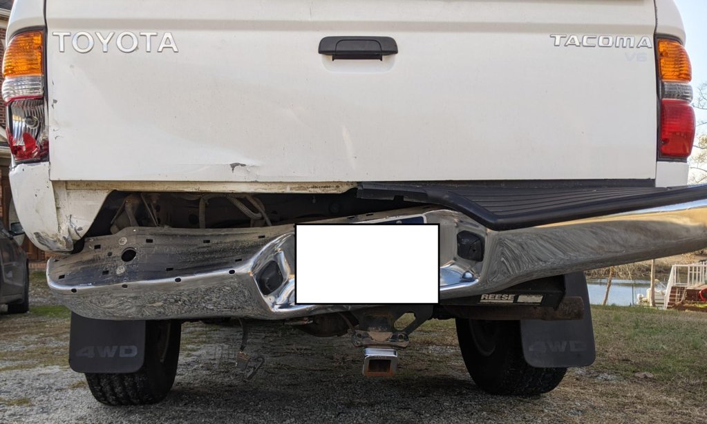

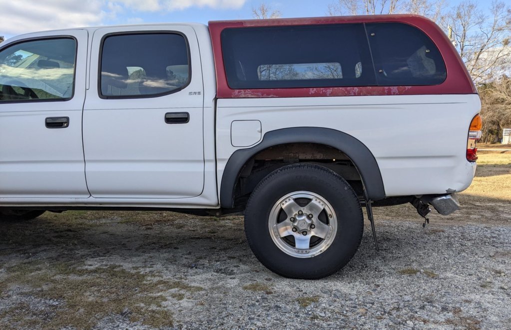

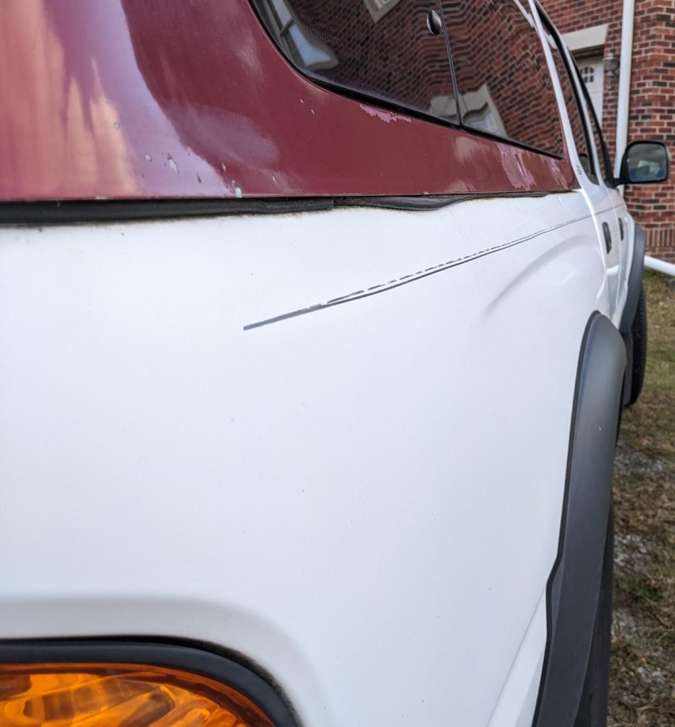

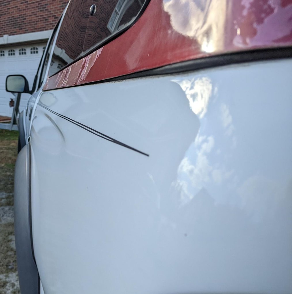

    Thanks in advance for any suggestions. I bought this great truck in 2004. It's completely stock (no mods) and I've really enjoyed it. Yesterday i was rear ended by the white midsize SUV shown. I was sitting still and am guessing the car that hit me was doing 45 without even touching the brakes. It was a real smack, but fortunately, the SUV seems to have absorbed most of the energy, though my frame is bent at the back.
    It is likely that my frame is bent on the left side forward of the rear axle a bit as the left side bed is sitting 3/4" higher than the right side bed over the rear tires. It is now tracking ever so slightly left which to me seems a further indicator that the frame unfortunately is bent ahead of the rear axle.
    This wonderful truck only has 165k miles on it and I'm afraid the insurance company is only going to give me 8k or so. I've not spoken with the adjuster yet. I was hoping to run this great truck for at least 8 to 10 more years. It's a real loss if i only get 8k and no more tacoma... no way i can get a good equivalent replacement for 8k.
    I'm in Columbia SC. I'm guessing i need to find a good frame shop to have a really good look.
    My questions are:
    1. how "bent" is this frame? I know my pictures don't really show the frame, but perhaps many of you will still have an instinct about it.
    2. Are frames able to be straightened enough to make repairing this worthwhile? I am hopeful the answer is yes.
    3. This is my first rodeo regarding this type of work on a frame and body work in general. Any suggestions are welcome.
    4. I'm especially hopeful that many of you tacoma folks know of good frame and body shops or individuals around the Columbia SC area.
    Most helpful for all of you tacoma faithful out there! Lane
    Will try to figure out how to attach these photos now.

  2. Jan 11, 2025 at 3:53 PM

    I can’t answer all your questions, but in 2018ish I had my frame “straightened” on a frame machine at my local body shop. Depending on how much you’re willing to put in, that might be your best option.

    It's totaled. You need to start pulling prices for comparable condition and mileage Taco's and make sure you are made whole. Only real way to partially repair would be a reframe or partial frame in a jig with plates. Neither of those will be covered by insurance.

    if you really, really, really want to run this truck to the end of time, allow the insurance company to do their thing, then ask for the buy-back amount. they'll total it out, but then you can purchase the truck back for far less. some people run it as-is, some will repair it, but at that point it'll be entirely out of pocket costs-- which can work for you in terms of body shop pricing being cheaper being a 'cash' customer--you could also pick and choose the damage that's repaired--ie, the rear cab corner is more aesthetic, so could be skipped at that point for saving money.
    but it also means it'll likely end up with a branded (rebuilt) title, which can be more difficult to insure, and is damn near impossible to ever sell. as an extremely crude baseline, rebranded title vehicles generally sell for about 1/4-1/2 of the same make/model/condition vehicle would sell for with a clean title.

    Frame shop would be the best bet re if it's possible to repair or just need to replace it. Shame either way.
    Assuming the frame isn't devastated, perhaps do the buyback and toss on a flatbed instead of the regular bed and cap.

    They are going to call that totaled. If you want to keep it you're going to have a battle moving forward to get them to assess it high enough but you may be surprised (story below.) If it's in the cards you can buy salvage rights and get it straightened at a body shop if the frame isn't rusting out.

    The answer is yes, frames can be straightened - and it used to be common. Finding a shop with a frame machine is the challenge, and you might look around for a vo-tech school (sometimes even high schools with a vo-tech), especially if insurance totals it and you buy it back.

    Thanks to everyone for your help! Wanted to give you all an update. I remeasured the truck and drove it more and had various folks look at it. The frame was actually not bent forward of the rear axle. I found a great independent body shop who helped me by submitting an estimate under the 70% (SC is 70% or 75% to total). And the insurance company agreed. They cashed me out at 8.8K without totaling my truck. I was really amazed and thankful!
    By talking to folks around here, i found the local guy who does the most frame work for the various big body shops. Just picked it up today. He straightened the frame at the very back where it was bent, leveled the bed and actually straightened out some of the corner dent for $800. Can't say enough about Ron Hicks (the frame guy). Anybody in SC, if you need a frame straightened, talk to him. Old school independent guy. Not sure if I'm supposed to share his contact info on this site. Can I? When i find a trustworthy dude, i want to promote him.
    I need to get a bumper, a hitch and a tailgate. I'm thinking of just going back with a regular bumper like what was on it (the chrome with black plastic flat top cover). Also i need to get a new hitch. The hitch that was on it was a Reese. Any suggestions on the best place to get both? I'd prefer to avoid purchasing stuff made in China though i realize that may not be possible.
