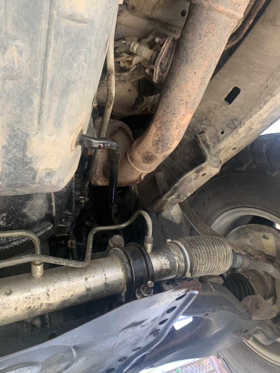

    Hey Everyone
    can someone please shed some light on what might be happening here???
    thank you in advance

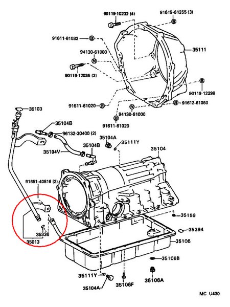

    That's the transmission dipstick tube. You need to take a closer look to determine where it's cracked. According to the parts catalog, there's a connection further upstream with an O-ring, but it should be above the normal fluid level, so I don't think it would be leaking from there:
