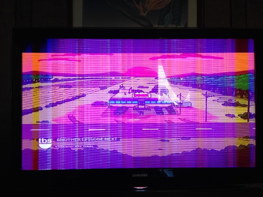

    So this just happen about a day ago. It's one of those first gen 46" LED's from Samsung that I got when it first came out. It's about 6 years old.
    Turned it on, and lines of rainbow looking lines are on the screen. And it ain't going away even when it's warmth up. Is this something that can be fix or the TV is pretty much reach its life span? What's wrong with it?
    Really love this TV, not really looking to throw cash on a new one.
    33BD9E01-E615-435C-A1B5-3AD3DCB12A68_zps_9e7c7bfaacfed2b42c48ee208068fce7d8323e26.jpg

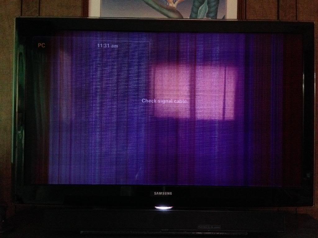

    When the screen is black.
    3BAAA73C-505F-4A48-AFF6-895E10D1265A_zps_e52c5f8a16dd9c3f174d9c3184c03f35222457c9.jpg

    It could be the capacitors in one a the cards or power supply, I think Samsung had problems with them. I would let a shop just check it and price the repair, may not be worth it.

    Unplugged main power cable, and waited for a couple minutes. No-go
    For the controller card is it easily accessible for me to inspect?
    All plugs are plugged in.
    I'll try and see if there's any electronic repair shops around.
    Cycled it on and off. Still no go

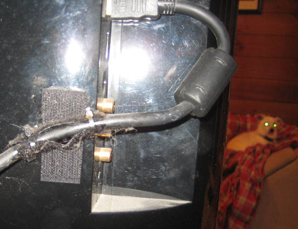

    So there are all sorts of stuff out there but I made my own and found them much sturdier than anything in the store...
    1. Buy some sticky velcro, heavy duty tape stuff...
    2. Stick a vertical of the 'hard' barbs on a clean surface of the back of your tv..about 3 inches
    3. Figure out a soft, natural tension free bend for your cable when you tuck it behind the tv..you can buy 90 degree connectors as well if you want.
    4. Stick the soft velcro length wise, again about 3 inches and the wrap it with zip ties 1/2 inch from each end...in the spot that should be where the loop comfortably sits.
    Now you can use the velcro to reduce the tension on the connector, especially when you have a tv on a swivel stand.
    I have a samsung and one of the reviews was the HDMI connectors wear out so I use 90 connectors and/or custom tension reducers on all my HDMI cables...$5 solution saves a lot of headaches...
    BTW...Ignore the dust, who cleans behind a TV...and that's my demon dog wally on his down throw...

    if you're going to troubleshoot this problem, first we'd want to know:
    a) what "input" the problem on?...
    b) is the problem on all inputs (assuming you have a couple HDMI, perhaps a component input?) try all the inputs, ...could be one is bad...
    c) what is the source? cable box, antenna, etc?... hook up a different source, to eliminate that as the problem...

    So I tried to recreate what was said on that thread. Tap on the HDMI port side to see if it goes away. No-go
    I don't think the problem is specifically on any input. I tried it on different settings, Cable, Air, HDMI connection, PS4, and it still displayed the same picture.
    No cable box, pretty much just a cable wire for the basic channels.
    1 HDMI connected.
    1 Optical cable for sound.
    So it must internally. I actually don't plan on openly it up, don't wanna make things worse haha.
    Gonna drop it off at a local electronic repair shop, and see what they say. If the repair cost is to high, then I might as well get a new TV.
    But we'll see what they say. Keep you guys updated.
