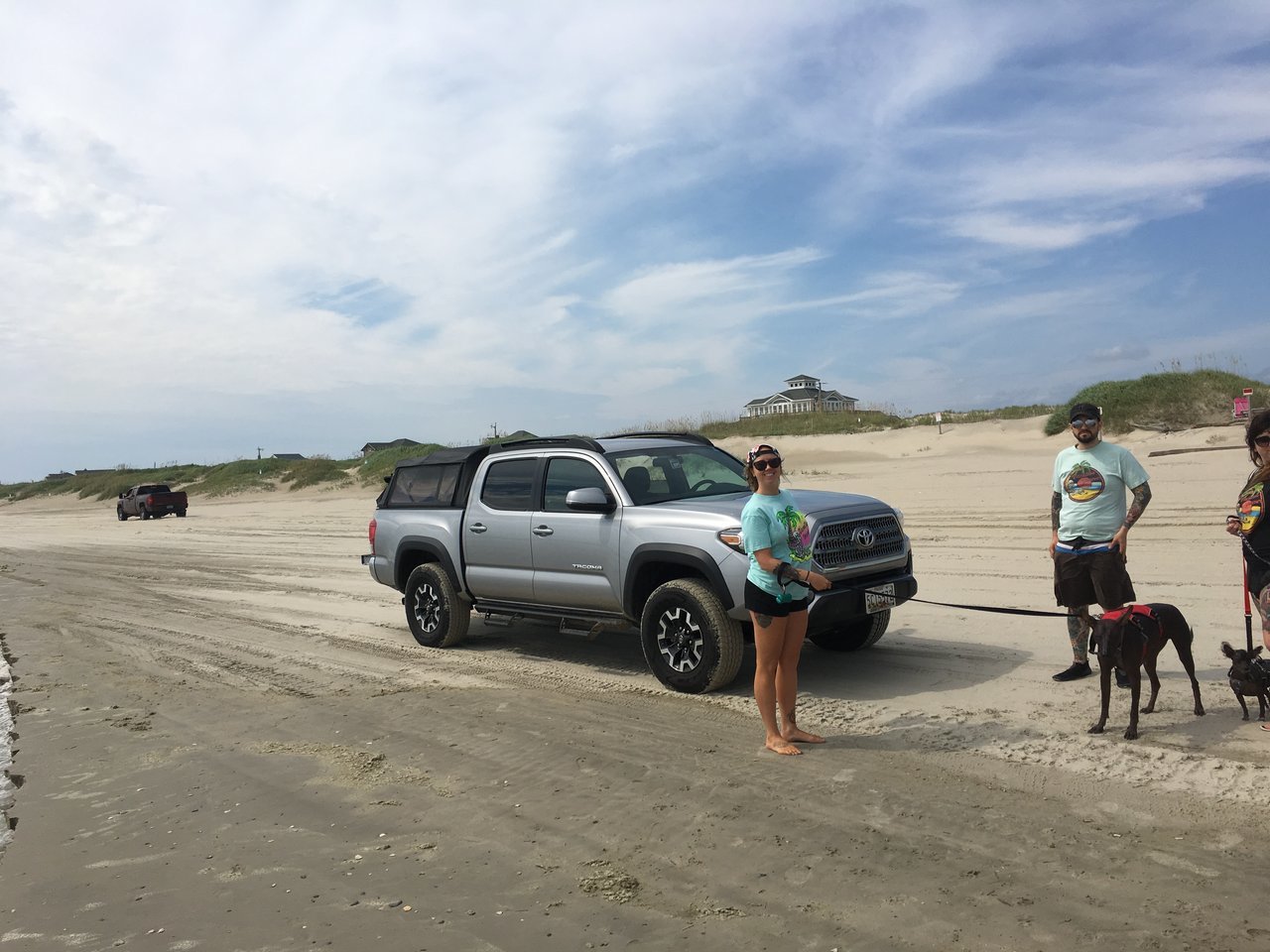

    Had a blast in Corolla/Carova, thanks again for the driving tips! I aired down to 20 and kept it in 4L in 3rd most of the time, which let me hover right at 2500 RPM and a comfortable 15 mph. Ran into many asshats who, like you said, treated the beach like the autobahn. One particular jerk in a honda pilot kept riding my ass the first half mile of the beach, and nearly hit me going around me, and another half mile down it was extremely satisfying to see him stuck in his AWD.
    All of the little trails back in the neighborhoods were a blast to drive around in! I'll def be making this a regular vacation spot in the future.
