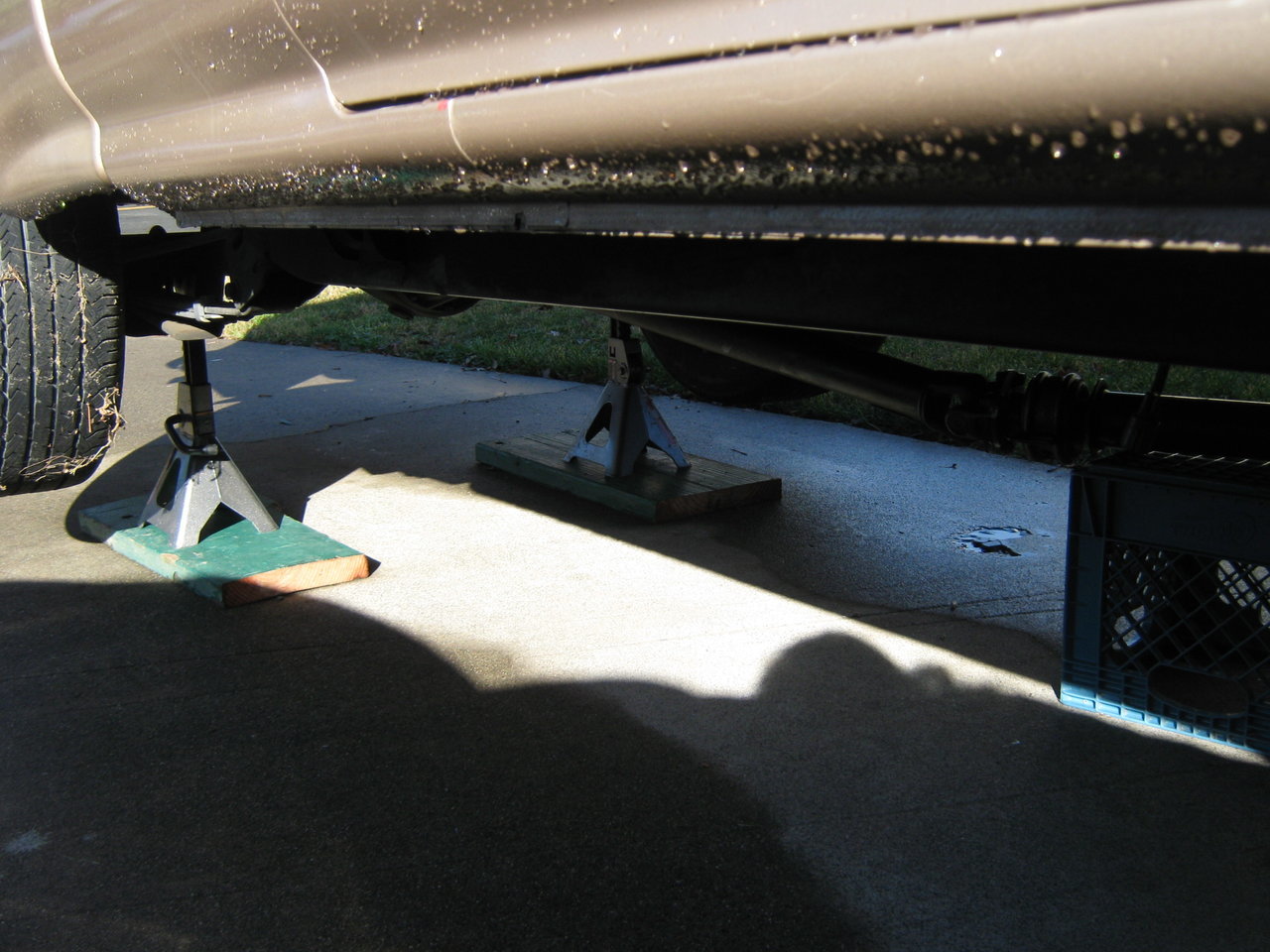

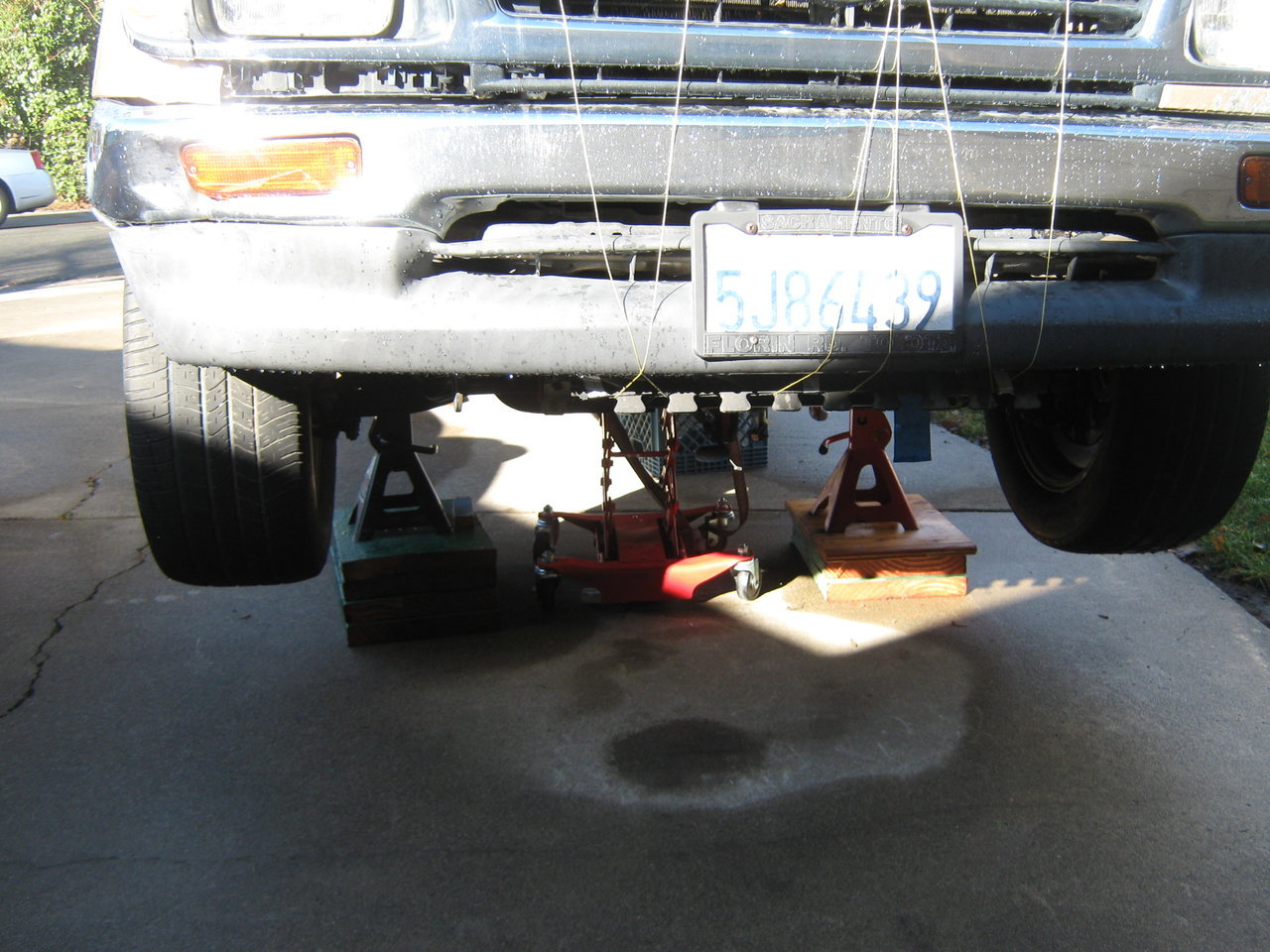

    currently:

    Got it. It would make it a lot easier to get it out of the way.
