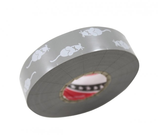

    I read something like that too a while back. Honda actually sells a rodent deterrent electrical tape. It's coated with capsaicin. While I do like spicy/chili peppers, I won't be tasting this stuff if I had some. :rofl:
    It's pretty expensive for a roll, like $40. Not sure if Hondas currently actually use this stuff these days stock. Can't say I've ever noticed electrical tape with the rodents symbols on them on newer Hondas or any vehicle from the factory. No idea if anyone makes similar electrical tape or how effective it actually is.
    P/N 4019-2317
    https://www.hondapartsnow.com/genuine/honda~tape~rodent~19mm~20m~4019-2317.html
