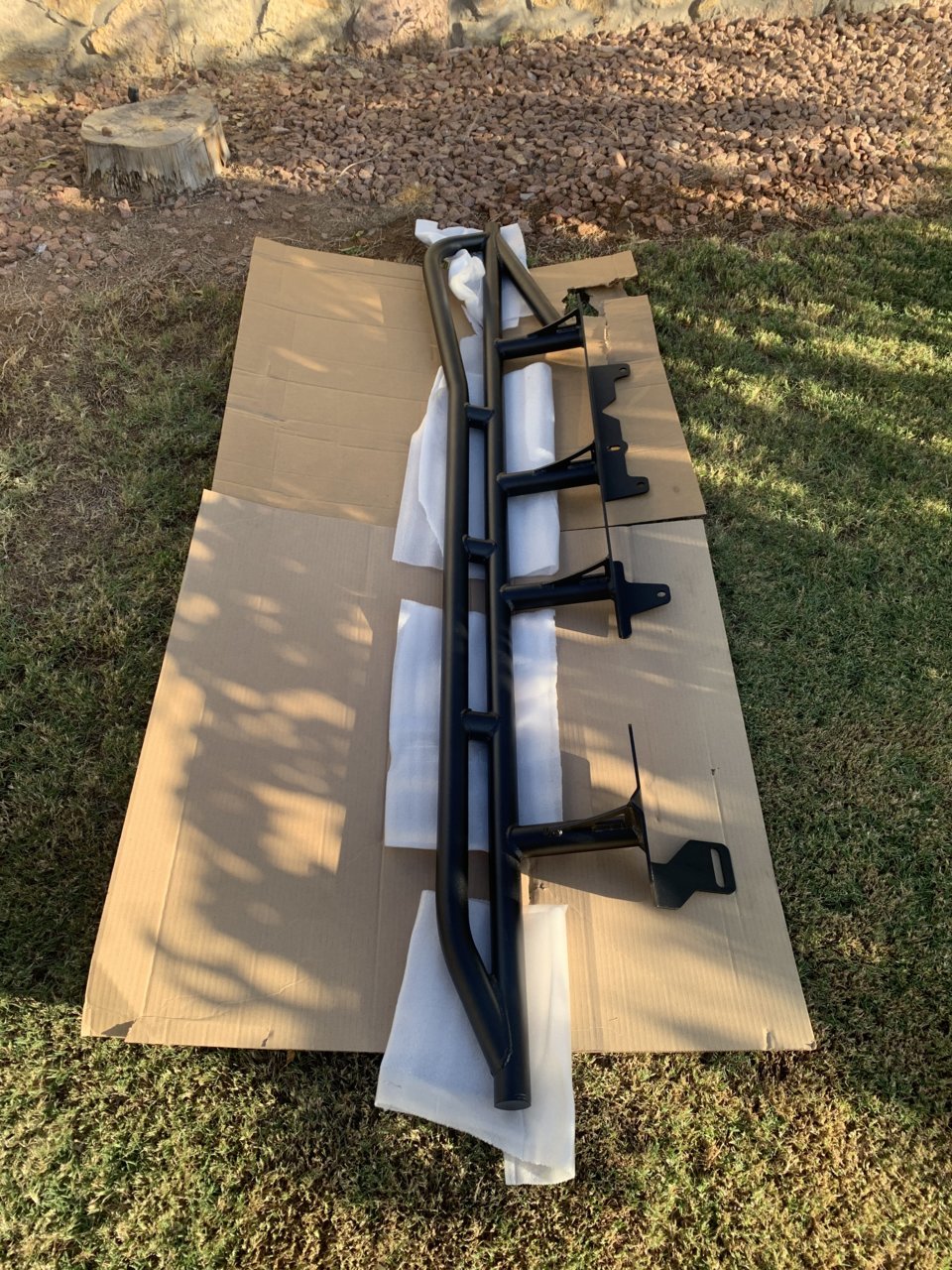

    About to install my Cali raised off-road 25 degree rock sliders with a kick out. Any tips and tricks from people that have done it before? They’re the bolt on option.
    Am I going to need a jack at any point? I got a buddy helping me out so it will be a 2 person install. Any insight is much appreciated, thanks!

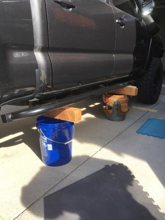

    I did mine alone:

    I did mine solo with two jacks
    Fun part was drilling the optional mounts and metal shavings in my hair
