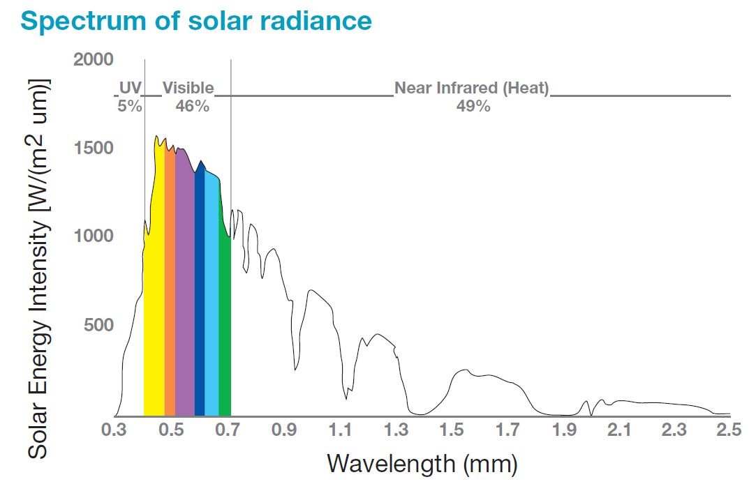

    On a 113º day here in AZ - you need to put some sort of shield in your windshield. The direct sunlight makes the dash interior so hot it won't pass cool air through the air delivery ducts for quite awhile.
    I did some research of infrared reflective paints and they do exist - makes it possible for USAF to paint airplanes black. Reduces temperatures of exposed surfaces by 20 - 30 degrees. Its not an insulator - its a reflector. Sherwin Williams even sells a house paint with infrared heat reduction capability for mastic or masonry. I'm sorely tempted to paint the large flat portion of the truck roof (many square inches are out of sight) with such a coating. I won't be seeing it - and only bigger trucks will glimpse it.
    The science is - that 49% of the infrared wavelengths (delivering heat) are invisible - and a coating that reflects them won't necessarily be visible to our eyes.
